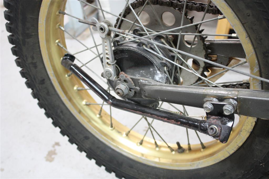

cholas Posted January 28, 2012 Report Share Posted January 28, 2012 Hello Does anyone have any idea of the length of an original TY Mono side stand? Any large diagrams/pictures would help as im looking at getting one made Cheers! Quote Link to comment Share on other sites More sharing options...

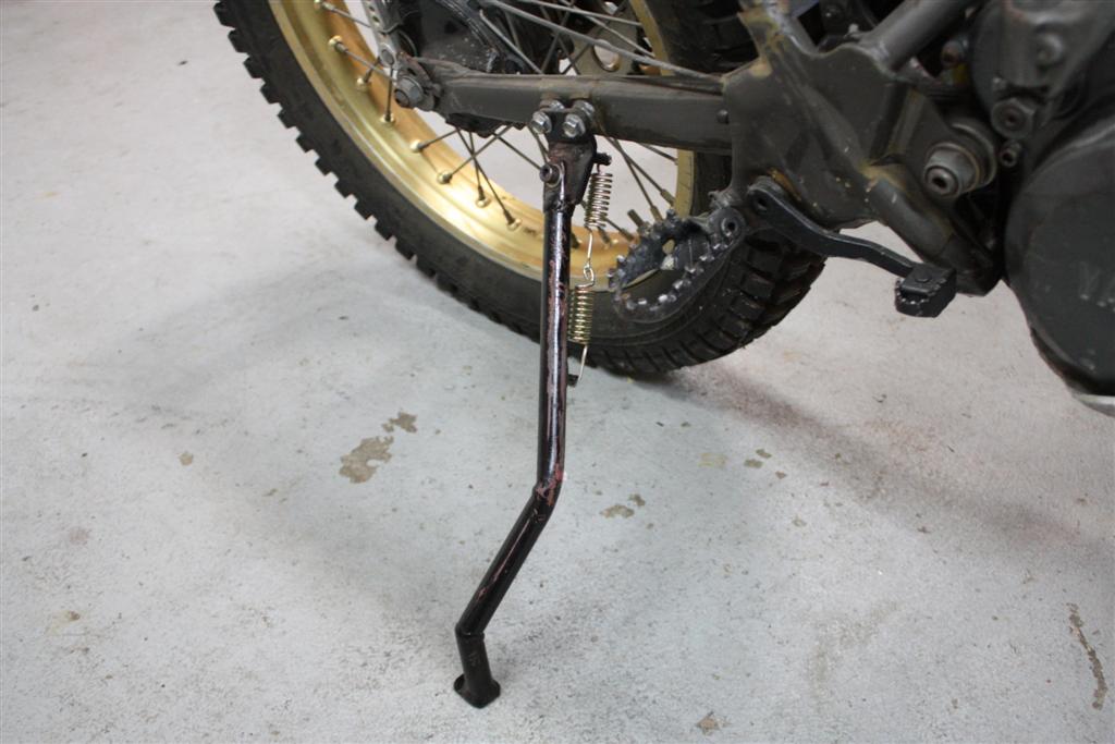

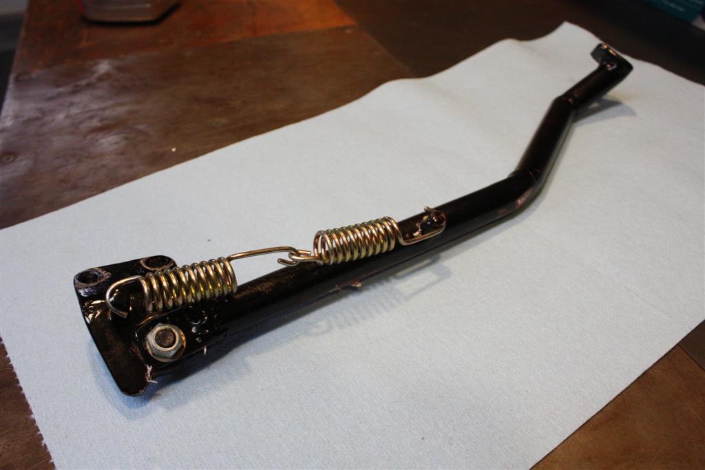

jse Posted January 29, 2012 Report Share Posted January 29, 2012 So then, anyone got one for sale? I made one for a TY350 loaner bike I let new riders try (much safer than letting them borrow the Pro) and I just took one off my other TY and used it as a pattern. Ask to borrow one from a friend to give to the fabricator to use as a pattern. Jon Quote Link to comment Share on other sites More sharing options...
cholas Posted January 29, 2012 Author Report Share Posted January 29, 2012 Thanks for the reply. I am the only one of my mates with a trialler. Ant chance of a pic or some measurements for my fabricator? Quote Link to comment Share on other sites More sharing options...
jse Posted January 30, 2012 Report Share Posted January 30, 2012 Thanks for the reply. I am the only one of my mates with a trialler. Ant chance of a pic or some measurements for my fabricator? I'll get the good camera out tomorrow and try to take some photos and measurements for you. Jon Quote Link to comment Share on other sites More sharing options...
cholas Posted January 30, 2012 Author Report Share Posted January 30, 2012 Superb. Thanks very much Quote Link to comment Share on other sites More sharing options...

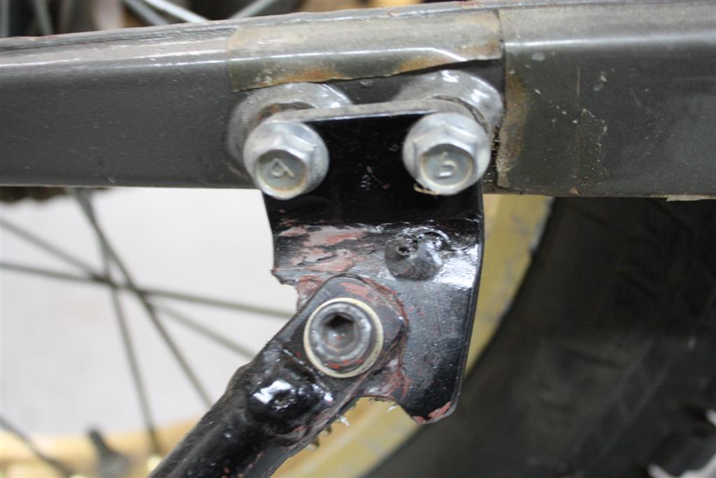

jse Posted January 30, 2012 Report Share Posted January 30, 2012 The bike is a TY350 I set up for new riders to try at events when they don't have a bike to ride yet. Although it has many updates and mods and goes, stops and handles well, it is purposely made to look "rough" with old, beatup plastic on it so the rider does not have a heart attack when, not if, they drop it in the rocks. The stand was quickly made from scrap so cost was nil. The "stealth" TY has started a LOT of new riders in Trials over the years. The thick wall tubing does not bend easily like the stock TY does. Approximate spec.'s: 20mm OD, thick wall tubing and 1/4' plate first straight length of stand-19.5cm second lengh-11cm third length-6cm Quote Link to comment Share on other sites More sharing options...
cholas Posted January 31, 2012 Author Report Share Posted January 31, 2012 That's excellent. Thanks for taking the pics and measurements. Much appreciated! Quote Link to comment Share on other sites More sharing options...
rosey Posted January 31, 2012 Report Share Posted January 31, 2012 As I recall we used to bolt them on the inside of the swinging arm too. It doesn't catch your boots then!... I cant remember if we had to bend anything though. Quote Link to comment Share on other sites More sharing options...
jse Posted January 31, 2012 Report Share Posted January 31, 2012 As I recall we used to bolt them on the inside of the swinging arm too. It doesn't catch your boots then!... I cant remember if we had to bend anything though. That's a good idea. You might have to bend the stand out a little to clear the spokes but I can see the advantage to it. Jon Quote Link to comment Share on other sites More sharing options...
