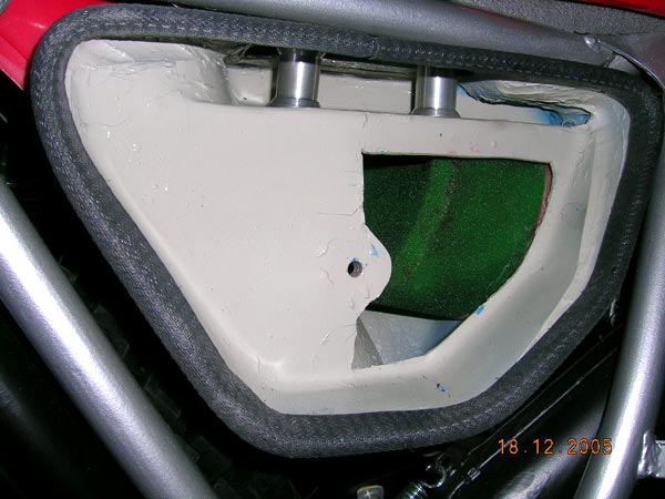

motovita Posted March 13, 2012 Report Share Posted March 13, 2012 Nice, the bike appears to have a non standard airbox. Is that a common mod? Can anyone tell me the details of the conversion? Quote Link to comment Share on other sites More sharing options...
cota200 Posted March 14, 2012 Author Report Share Posted March 14, 2012 (edited) Hello Motovita, Glad you enjoyed the videos. At least in Spain it is a quite common mod. The airbox comes from a standard Bultaco 183. It was an earlier model but the airbox was much bigger´and carb breathes much better. It fits straight in. If you fit it to a 199 you dont even have to paint it. Here is a detailed inside picture (found it at todotrial, the trials online reference publication in Spanish): Regards, cota200 Edited March 15, 2012 by cota200 Quote Link to comment Share on other sites More sharing options...
