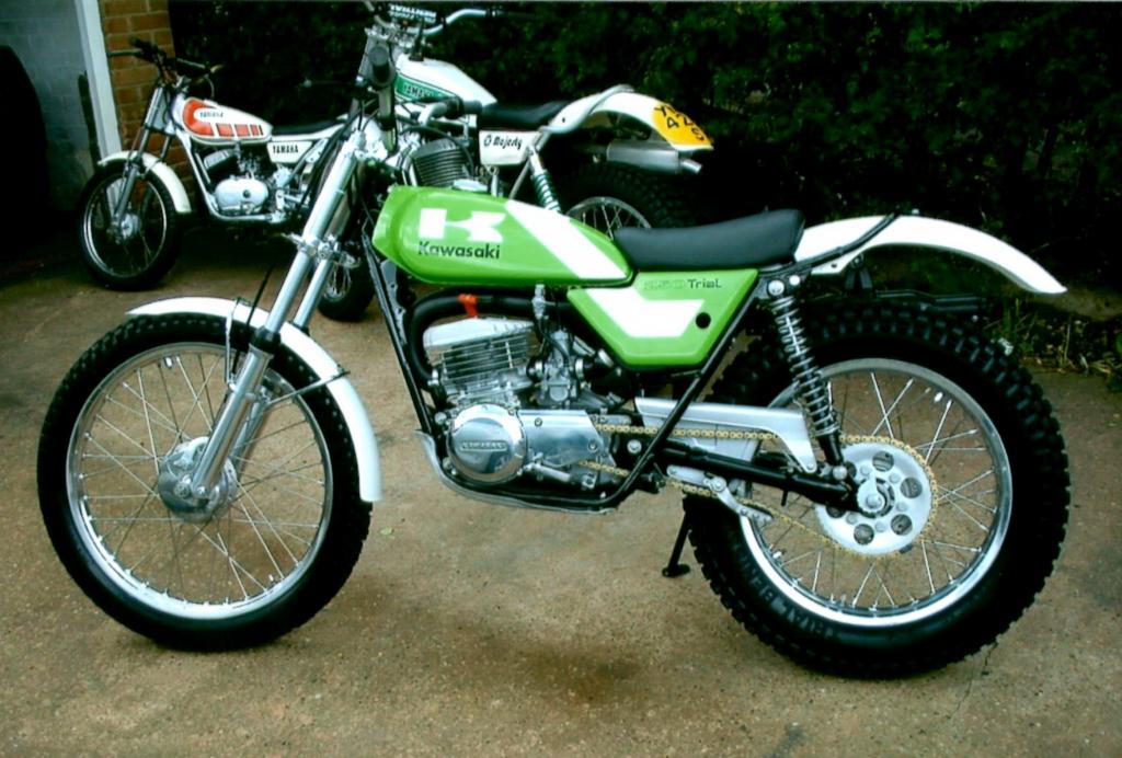

twinshockdude Posted February 26, 2014 Report Share Posted February 26, 2014 Kawasaki kt250 after restoration 5 Quote Link to comment Share on other sites More sharing options...

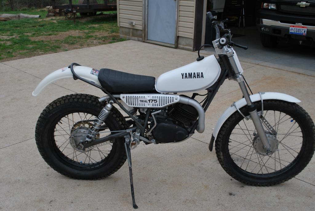

shercosteve Posted April 23, 2014 Report Share Posted April 23, 2014 My TY 175 5 Quote Link to comment Share on other sites More sharing options...

gig755 Posted April 25, 2014 Report Share Posted April 25, 2014 On 4/23/2014 at 9:55 PM, shercosteve said: My TY 175 I've seen this bike in person, and it's a very trick TY. It sounds really good, and has a lot of handmade parts. He even completely handmade the pipe and silencer! Shercosteve is not only a great fabricator, but he's also a heck of a rider, and he took 1st place on this bike at our last event. 2 Quote Link to comment Share on other sites More sharing options...
shercosteve Posted April 25, 2014 Report Share Posted April 25, 2014 (edited) Thanks for the kind words! In total this is one of three 175's that I have built. They are so much fun to ride. Summary of my mods, Billet triple clamps with the fork tubes parallel to the stem, TY 250 forks Magical, valving, adjustable caps and progressive springs, My own version of the all in one exhaust and header pipe, ported cylinder, boyesen 2 stage reeds, modified stock airbox, lengthened swing arm, moved upper shock mounts and betor shocks, black excel wheels with buchanan stainless spokes. I'm also using a electronic ignition and a Mikuni VM 26 carb. I almost enjoy riding this bike more than the moderns anymore. Steve Edited April 25, 2014 by shercosteve Quote Link to comment Share on other sites More sharing options...
htrdoug Posted April 25, 2014 Report Share Posted April 25, 2014 (edited) On 4/25/2014 at 12:58 AM, gig755 said: I've seen this bike in person, and it's a very trick TY. It sounds really good, and has a lot of handmade parts. He even completely handmade the pipe and silencer! Shercosteve is not only a great fabricator, but he's also a heck of a rider, and he took 1st place on this bike at our last event. Oh yea,Means he will be riding the "Equalizer" line at my event in October. BTW Steve,Super and I were messing around and found that it looks like a Reflex swingarm will fit a TY175 with a few mm trimmed off each side,we just didn't have a healthy arm to try it out on. Edited April 25, 2014 by htrdoug 1 Quote Link to comment Share on other sites More sharing options...
