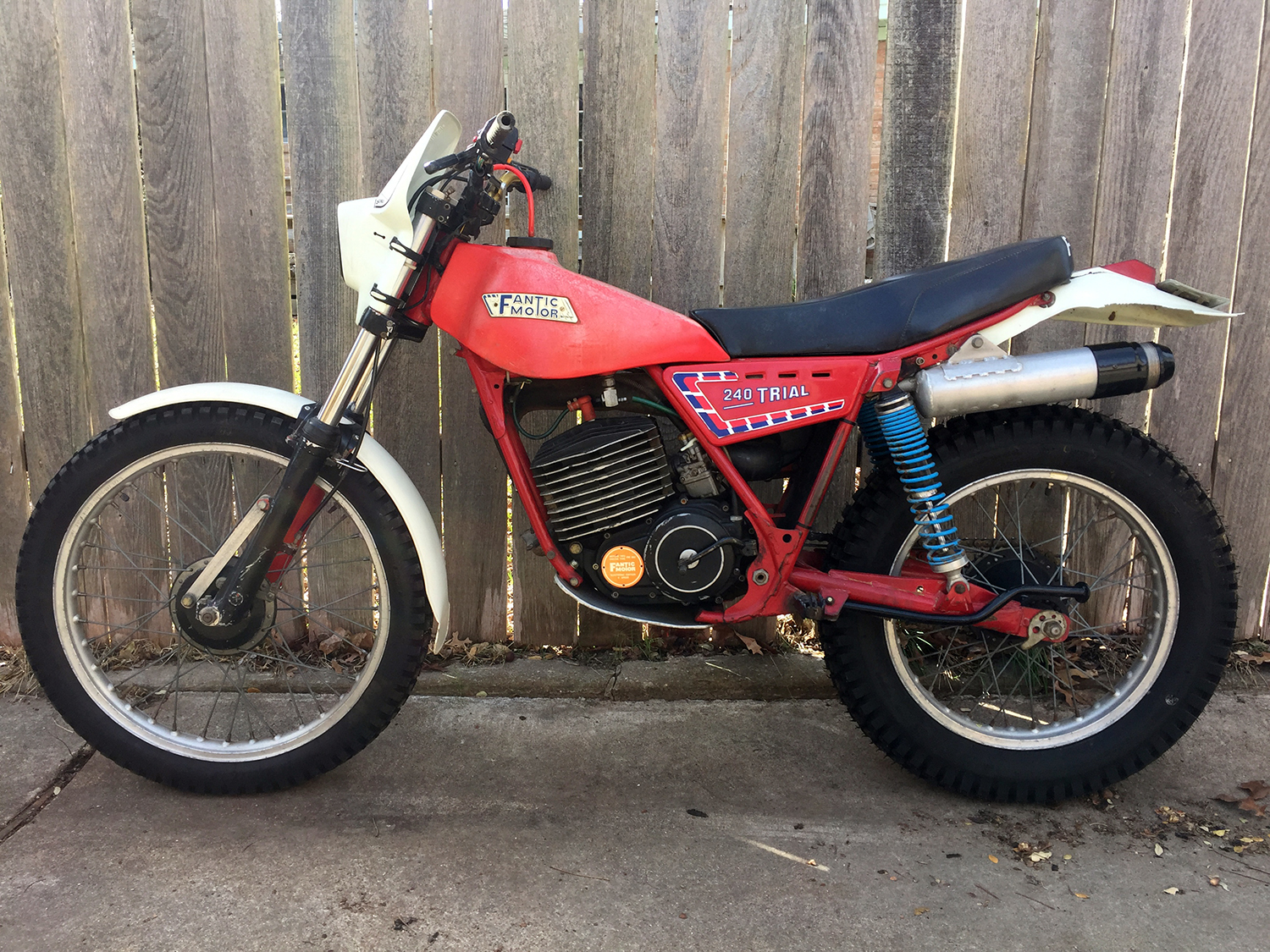

robbiesty175 Posted December 30, 2016 Report Share Posted December 30, 2016 On 12/26/2016 at 9:01 AM, axulsuv said: That ain't no Fantic !!!! This better? Got my Fantic yesterday and today I clean... 1 Quote Link to comment Share on other sites More sharing options...
john b Posted December 30, 2016 Report Share Posted December 30, 2016 My sons TY 175 that he's just rebuilt for kia champs next year 9 Quote Link to comment Share on other sites More sharing options...
axulsuv Posted December 31, 2016 Report Share Posted December 31, 2016 11 hours ago, robbiesty175 said: This better? Got my Fantic yesterday and today I clean... FIRST THING !!!! , Get the tank off it and check for cracks in the head stock area ! looks a bit relaxed ... And then measure from the front axle to the swingarm pivot and let me know where it is .... Quote Link to comment Share on other sites More sharing options...
axulsuv Posted December 31, 2016 Report Share Posted December 31, 2016 And then strip it and put it in the new frame you've got ..... 1 Quote Link to comment Share on other sites More sharing options...

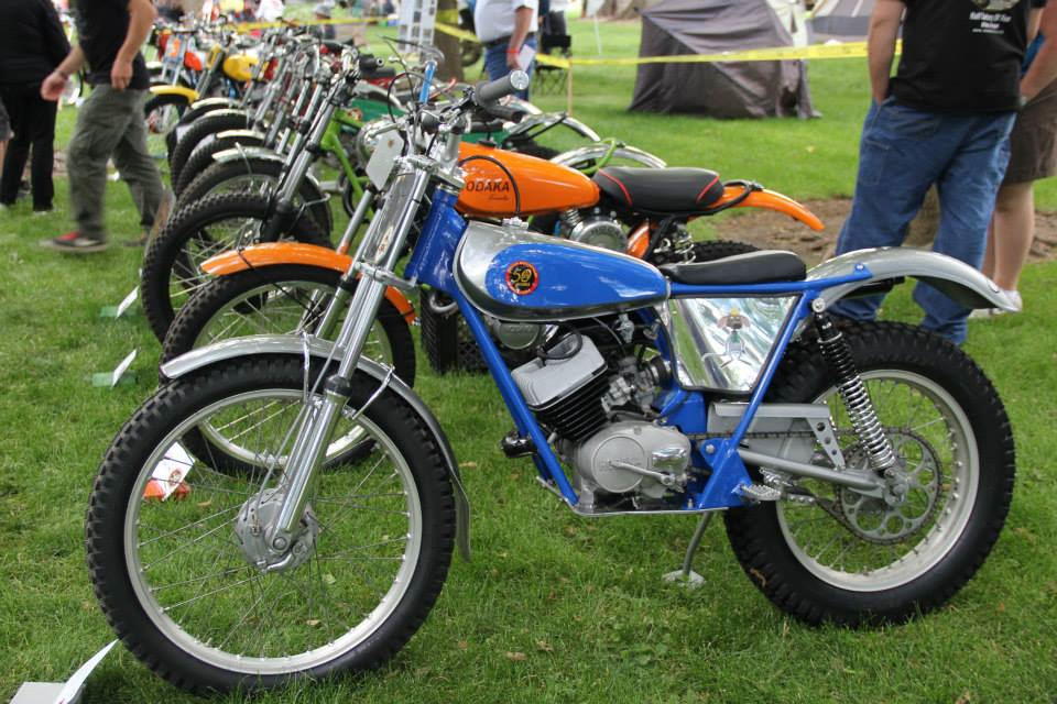

ty todd Posted January 3, 2017 Report Share Posted January 3, 2017 Here is my Hodaka special at Hodaka Days 2014 bike show. 6 Quote Link to comment Share on other sites More sharing options...
scot taco Posted January 3, 2017 Report Share Posted January 3, 2017 (edited) That turned out really nice Todd! Would you be willing to share any details about the build? I,m curious what gas tank that is and how you did your exhaust,motor mods etc. I am working on a trials Ace 100 over this winter and have a Wombat waiting in the wings that will also be built as a trials bike. Edited January 4, 2017 by scot taco wanted to ask a more detailed question Quote Link to comment Share on other sites More sharing options...
steve fracy Posted January 4, 2017 Report Share Posted January 4, 2017 I have a 125 Hodaka trials bike in a Challenger or Wassel frame here. It ran when I bought it some years ago. If you know of anyone looking for one? Quote Link to comment Share on other sites More sharing options...
ty todd Posted January 4, 2017 Report Share Posted January 4, 2017 22 hours ago, scot taco said: That turned out really nice Todd! Would you be willing to share any details about the build? I,m curious what gas tank that is and how you did your exhaust,motor mods etc. Thanks you. The bike started life as a TL125. The only Honda bits left are the fork, wheels, swing arm and back bone. Everything else have been modified. All the new tubing is chrome moly. I lowered and moved back the pegs. This took some time and a few changes to get the bike feeling comfortable. The swing arm now supports the kick stand and also a chain tensioner from a KT250. The shocks have been move forward to about where the stock seat mounts once were. The steering head was cut and moved forward to about 24deg. The upper tube width was determined by how wide the seat was going to be. The seat is from the front 10" of a KTM seat that rides up the tank. The gas tank is Yamaha DT100. The engine is a reeded Combat Wombat 125. I think what really makes the motor work well is the gearing and the pipe off a RM90. My friend Joe said I think it will help with the power through the rpm's (plus I think he wanted to build the pipe). He was right. Good bottom end and when you need more it's there but not crazy snappy. The bike is fun to ride but I made it to pretty. Now I'm afraid to scratch it. So I have to build another Cheers 4 Quote Link to comment Share on other sites More sharing options...
ty todd Posted January 4, 2017 Report Share Posted January 4, 2017 22 hours ago, scot taco said: I am working on a trials Ace 100 over this winter and have a Wombat waiting in the wings that will also be built as a trials bike. Hi Scot A lot of people feel the Ace100 is a good choice. I agree only if you are a smaller person. I compete on a TY175 and feel big on it. On an Ace100 I feel ready big. I'm preparing to build another bike using frame bits from a Wombat and a lot of TY stuff. One of the main things I am going to do different is use a cylinder from a Wombat (and reed port it) or an 03 Wombat cylinder. The exhaust port is lower. I also feel the exhaust made the other bike much better. Good luck on your builds. Let me know if you have any more questions. Cheers 1 Quote Link to comment Share on other sites More sharing options...
scot taco Posted January 4, 2017 Report Share Posted January 4, 2017 That turned out really nice Todd! Would you be willing to share any details about the build? I am working on a trials Ace 100 over this winter and have a Wombat waiting in the wings that will also be built as a trials bike. Thanks Todd for all the info. You have put a lot of work into that bike and it shows.I think I have seen pics on the web of another TL/Hodaka at Hodaka Days that left more of the frame there and the TL tank.There are a lot of cool customs out there. The Ace based bike will be for my daughter to learn on and if she doesn,t like it it will get more mods for me to use,The older I get the more a smaller bike sounds good! I like the DT tank and I think that might fit a Hodaka frame because I have seen the Carke YZ tanks on Combats. I have an enduro cross reed cylinder to go with the Wombat project bike,but I might stick with the stock piston port cylinder,not sure just yet. Thanks again! Quote Link to comment Share on other sites More sharing options...
still trying Posted January 5, 2017 Report Share Posted January 5, 2017 Todd what a well executed build, well done. Have you any progress photo's you could put in the projects gallery? It might inspire more people to get creative. Enjoy riding and tuning your new (?) machine, brilliant! 1 Quote Link to comment Share on other sites More sharing options...
