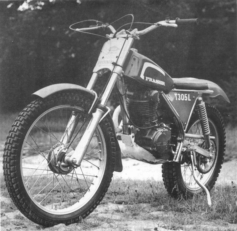

gbmoto Posted May 2, 2005 Report Share Posted May 2, 2005 The Spanish bike does look like a Fraser 305 ( see pic from 4 stroke finale )but with a lovely tank seat. I would love a tank/seat like that for my TL 250, I will post a pic seperately. Quote Link to comment Share on other sites More sharing options...

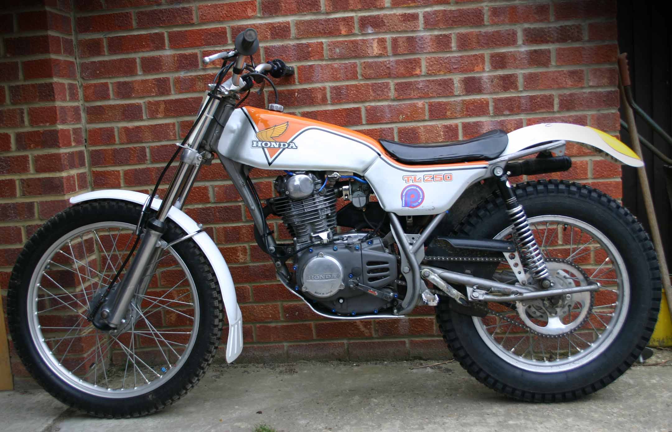

gbmoto Posted May 2, 2005 Report Share Posted May 2, 2005 This is my TL250 which I use regularly. The frame was modified before I got it but has been done well and helps a lot, I have built 2 engines for it, tl bottom ends with XL head ( bigger valves ) xl flywheel ( a lot heavier than the TL one strangely ) and with a nos powroll 280 piston. The other engine will be taken out to 305 again with a powroll piston. The tank took a lot of work to get like that and each side panel was made up from 4 pieces, not from the same panels! ( I had a leg in plaster at the time so could spend plenty of time on them!) I would be really interested in a works style 305 tank/seat for this bike in any condition. Quote Link to comment Share on other sites More sharing options...
