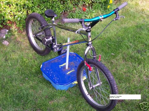

smidge Posted May 4, 2005 Report Share Posted May 4, 2005 Yep i do a bit a bmx ridin heres a pic of me bike. Quote Link to comment Share on other sites More sharing options...
