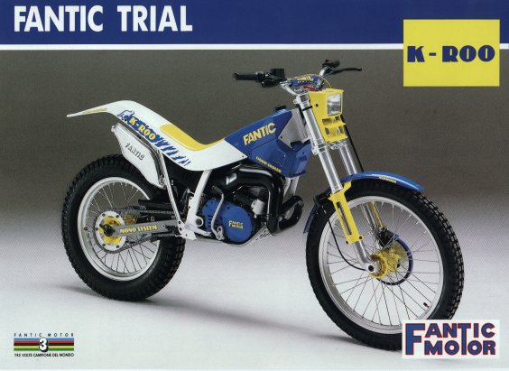

ba baraccus Posted April 25, 2005 Report Share Posted April 25, 2005 (edited) Ok I am trying to clean up an old K-Roo Fantic and I was just wondering what methods you guy use to clean up the old unpainted white mudguards that this bike and many other Fantics had? Its the big rear guard/seat panel and I would like to get it something like white again Cheers guys for any tips Edited April 25, 2005 by BA Baraccus Quote Link to comment Share on other sites More sharing options...

motopat Posted April 26, 2005 Report Share Posted April 26, 2005 Ok I am trying to clean up an old K-Roo Fantic and I was just wondering what methods you guy use to clean up the old unpainted white mudguards that this bike and many other Fantics had? Its the big rear guard/seat panel and I would like to get it something like white again Cheers guys for any tips looks pretty white to me - are you sure it needs doing? Quote Link to comment Share on other sites More sharing options...
ba baraccus Posted April 26, 2005 Author Report Share Posted April 26, 2005 Do you mean the one in the picture looks white? Erm that one is'nt mine mate thats the sales brochure pic Quote Link to comment Share on other sites More sharing options...
motopat Posted April 26, 2005 Report Share Posted April 26, 2005 Do you mean the one in the picture looks white? Erm that one is'nt mine mate thats the sales brochure pic I was having a giraffe Quote Link to comment Share on other sites More sharing options...
