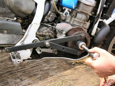

dadof2 Posted June 4, 2012 Report Share Posted June 4, 2012 Its hard to describe in writing but here goes. You want 2 pieces of metal bar about 8m thick, 40mm wide and 50mm longer than the distance from the flywheel nut to the footest. Drill 8mm holes about 10mm in from each end of both bars. Fasten the bars together with an M8 bolt and nut at one end so they form a V. Put M8 bolts through the other holes and tighten nuts on. The heads of the bolts at the open end of the V can then be located in the holes in the flywheel and the other end held or jammed on the footrest. Alternatively a garage with a windy gun should be able to do it. Cheers Quote Link to comment Share on other sites More sharing options...
copemech Posted June 5, 2012 Report Share Posted June 5, 2012 Like this! Many use a 3mm drain hole in the bottom of the cover to let crap out. Quote Link to comment Share on other sites More sharing options...
pindie Posted June 5, 2012 Author Report Share Posted June 5, 2012 Cheers both. Simple tool made, flywheel nut undone! I'll get a puller tomorrow and see if i can get this "fix" completed. Quote Link to comment Share on other sites More sharing options...
