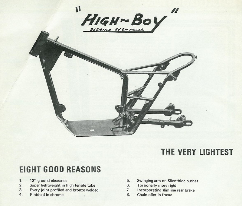

bultaco49 Posted June 14, 2012 Report Share Posted June 14, 2012 The frame in Blackcats article is a later version than that in Zisco's or mine - and was a bit of a handful for the reasons stated! The earlier frames had a single pillar under the seat (picture below) much like the later model 49 & model 80 and was very similar to model 80. Frame had a tendancy to break at the base of the headstock gusset Tim Quote Link to comment Share on other sites More sharing options...
