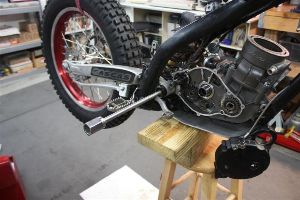

jse Posted July 3, 2012 Report Share Posted July 3, 2012 Or, make yourself one of these like I did. It threads into the pivot shaft end to push it out or to pull it back in (the length makes it easy to align the end into the inside recess of the frame, which is where you are having trouble. The short one I carry in the trailer toolbox for emergency use in the field. The long one gets more use and is in the shop. Jon Quote Link to comment Share on other sites More sharing options...

gazzaecowarrior Posted August 18, 2016 Report Share Posted August 18, 2016 Or, make yourself one of these like I did. It threads into the pivot shaft end to push it out or to pull it back in (the length makes it easy to align the end into the inside recess of the frame, which is where you are having trouble. The short one I carry in the trailer toolbox for emergency use in the field. The long one gets more use and is in the shop. Jon I'm going to buy a bolt to help align my swing arm bolt. I see you made up one. I measured the bolt which inserts into the spindle as m14 but I'm unsure as to the pitch. Is it 1.5 or 2.0 ? Regards Gareth Quote Link to comment Share on other sites More sharing options...
