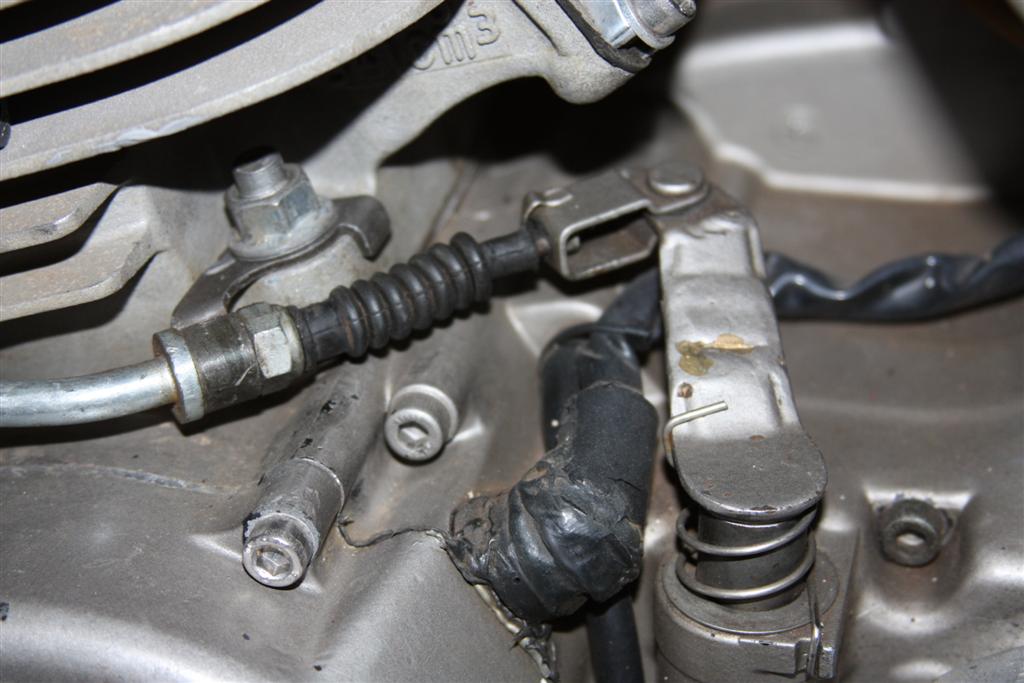

I extended mine 10mm. You'll need to pull the clutch pressure plate to pull the rod out slightly so the lever shaft will clear and it should just come out.
Three other things helped: replace the cable internal with woven aircraft control wire and thread the end of the outer cable ferrule at the bottom end and use a nut to cinch it up where it goes through the holder on the left, rear cylinder stud (see photo). This will keep the ferrule/housing from flexing and makes the clutch action more "direct" feeling. You'll also notice that I canted the very tip a little to the left so it has a more direct pull. My TY is a one-finger pull and feels very smooth.

These mods were done over 20+ years ago and still work fine. Angling the tip and securing the ferrule takes the slop out of the cable allowing for a "normal" setting of the lever throw. Next time you get a chance, pull on the TY lever and most likely you'll notice the ferrule wiggle at the lower mount, it's surprizing how much it affects the engagement. I know the aftermarket machined extender you mentioned and just about everybody used them. Unless you are restoring a collector's bike and want it absolutely stock, if you are going to ride the bike it's some mods to consider.
