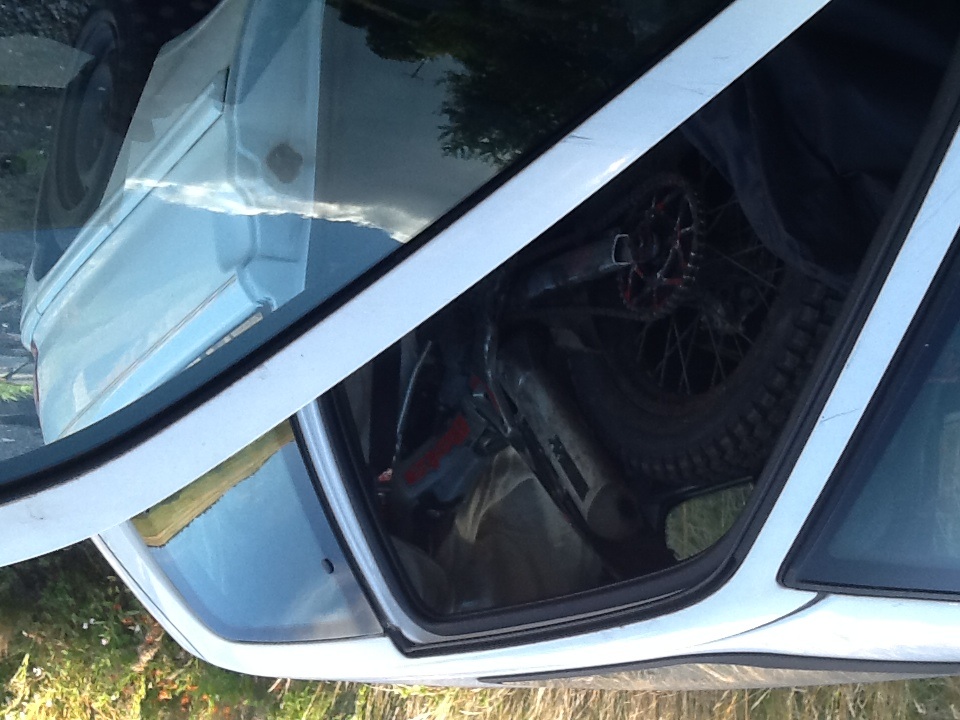

mxmarc Posted August 27, 2013 Report Share Posted August 27, 2013 I fit mine in a saxo.. Take the front wheel off and flip the front seat forward.. The back wheel sits in the hole..., and then strap the forks down so i can shut the boot... My car is a shed so I'm not to worried about scratching it.. Thats the only problem.. Quote Link to comment Share on other sites More sharing options...
