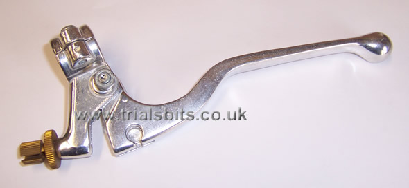

b40rt Posted August 28, 2012 Report Share Posted August 28, 2012 I prefer this type if using one finger. Quote Link to comment Share on other sites More sharing options...

robf Posted August 30, 2012 Author Report Share Posted August 30, 2012 Thanks for all the replies. Quite a bit of support for the Dominos but leverage is something that I need to consider as the clutch routing on the twinshock TY250 isnt exactly ideal I am quite tempted by some on John Cane's TY site - I think they are made by Apico ( forged ) and have 3 positions on the lever for the nipple so you can adjust the ratio - has anyone tried these ? Quote Link to comment Share on other sites More sharing options...
b40rt Posted August 30, 2012 Report Share Posted August 30, 2012 Yes, use one on my SWM. Only used it with the nipple closest to the bars position, what you gain in leverage you lose in disengagement so not perfect. Would still recommend it though. Quote Link to comment Share on other sites More sharing options...
robf Posted August 30, 2012 Author Report Share Posted August 30, 2012 Thanks B40rt Does the lever have a bush or does it run with the hole in the ally straight onto the lever pivot bolt ? Quote Link to comment Share on other sites More sharing options...
b40rt Posted August 30, 2012 Report Share Posted August 30, 2012 Sorry, cant remember as its been on for a year or more, probably plain. Got it here http://www.trialsbits.co.uk/product_info.php?cPath=83_179&products_id=1738 e.mail them and I'm sure they will be able to tell you. Quote Link to comment Share on other sites More sharing options...
