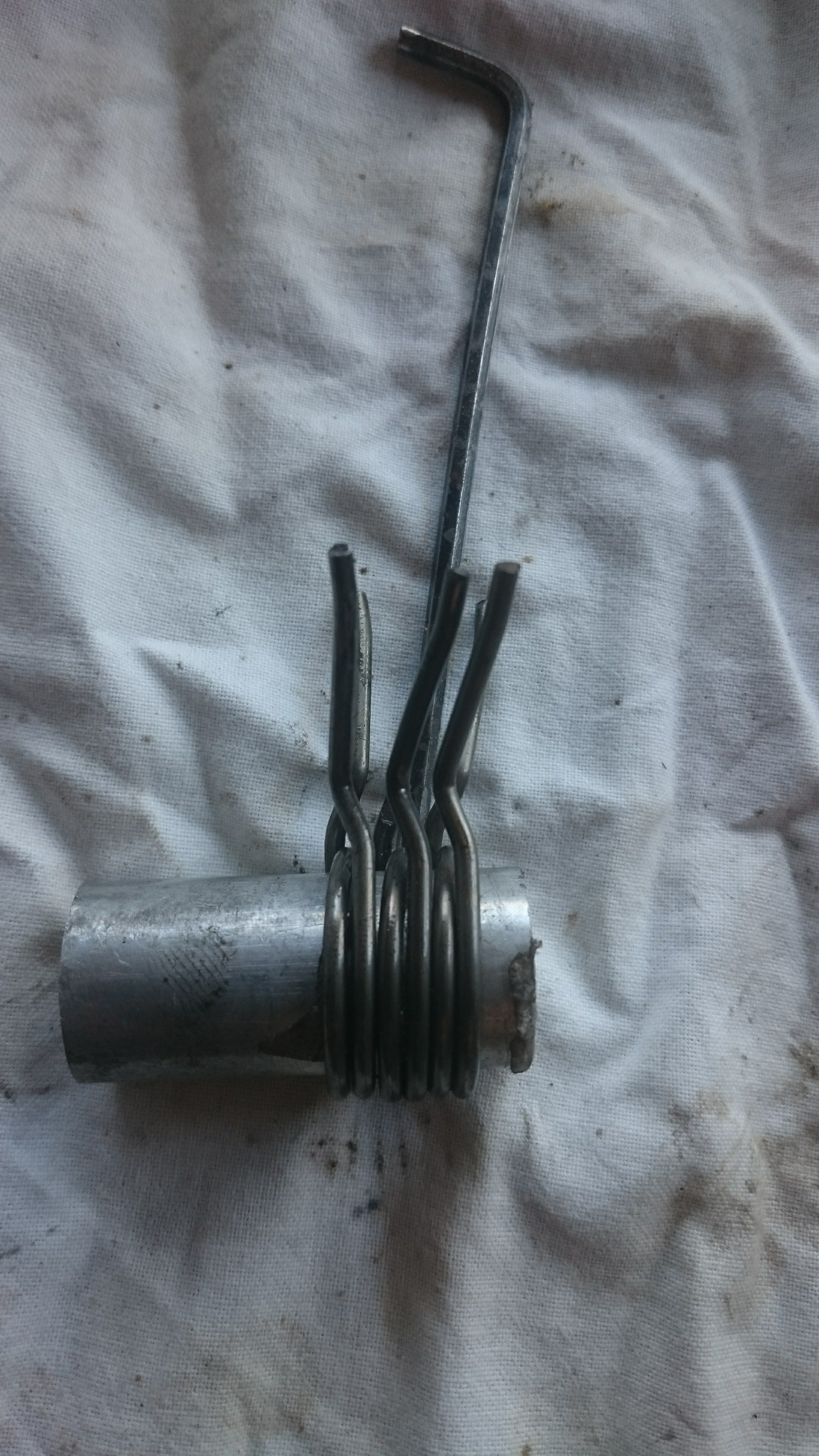

bikerpet Posted September 18, 2018 Report Share Posted September 18, 2018 Today I finally replaced the spring with one I modified to match the broken original (minus the break). Eureka - it is still working after an hour riding so I'm going to say it's fixed. So if you buy a replacement spring for your Sherco carefully compare it to the original working one and modify it to match if it isn't the same. In the photo I've attached here the original is in the centre, the new incorrect one is on the left and a new one modified to match the original is on the right. Now to fix the stripped clutch housing bolt from all this on-again off-again - it didn't get close to torque before it stripped, strange as it spun in easily. Am I impressed with Sherco quality do you think? Quote Link to comment Share on other sites More sharing options...
