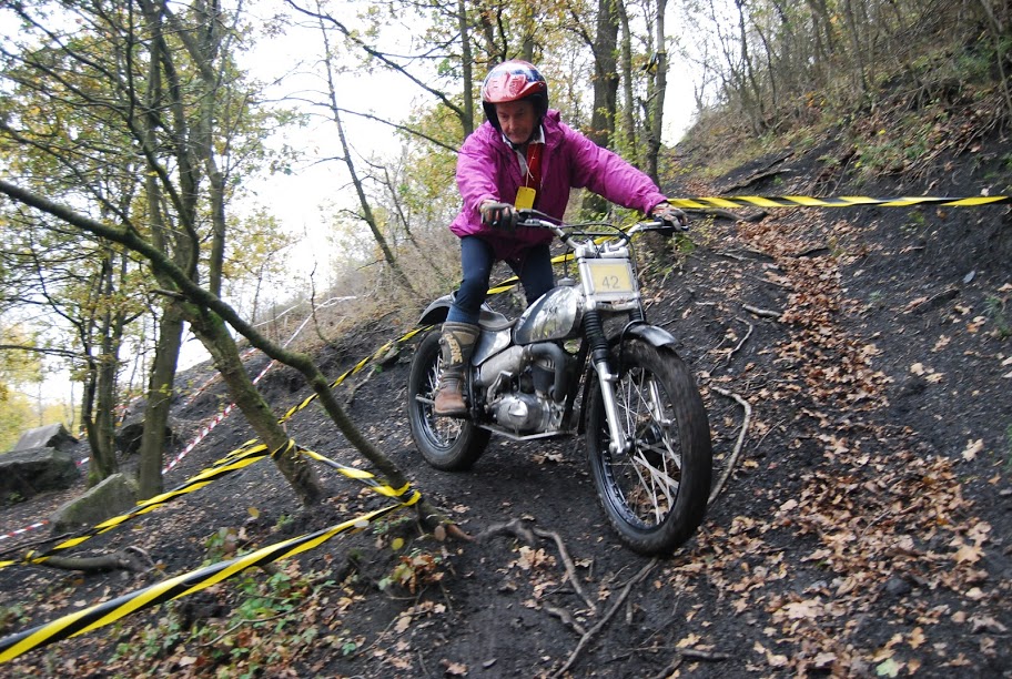

b40rt Posted November 15, 2012 Report Share Posted November 15, 2012 (edited) Mons Trial last weekend. Edited November 15, 2012 by b40rt Quote Link to comment Share on other sites More sharing options...

pat Posted November 21, 2012 Report Share Posted November 21, 2012 (edited) Thanks b40rt, Mons will be in my travel plan for next year.. Peters packing/architecture of fuel tank, seat and muffler is one of the best Banters Ive seen. Have planned this height positioning of fuel tank, tunnel vs top tube like a speedway-ish fuel tank position..and sub frame height vs head, fun to see it executed Edited November 21, 2012 by pat Quote Link to comment Share on other sites More sharing options...
