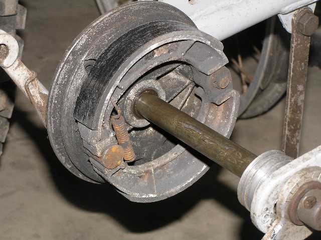

brt650 Posted November 30, 2012 Author Report Share Posted November 30, 2012 (edited) I think Brian is asking about the front brake The front brake first and then I'll get onto the rear. I did read David that you were considering the Fantic 240 shoes in a post from 2008. (http://www.trialscentral.com/forums/topic/17506-sherpa-t-brake-shoe-pivot-arrangement/ ) Did you end up trying that? I was considering the offset anchor end maybe causing some side effects. I made a ring 125mm round and fitted over the brake to see what was happening. The shoes under varying pressure move all over the place. I believe your comments from 2008 would help alleviate this. Cheers Brian P.S. Mum sends her love Edited November 30, 2012 by brt650 Quote Link to comment Share on other sites More sharing options...
pschrauber Posted November 30, 2012 Report Share Posted November 30, 2012 Mmmh, looked up the post from 2008 When I look at the pic's from this posting: I see a drum brake with pads that are not friction linings, instead sliding linings. These pads have a glazed surface by the left over/debris of brake pad material. So no wonder that they don't work properly. Maybe this is forgotten wisdom as drum brakes on trials bikes where less and less fitted with the mid eighties ... Drum brakes has to be maintainced regulary here: - the hollow space, - the pads and - the mechanism should be cleaned regulary from the remains of the brake pad's and other debris as this will clogg the surfaces of the pads. The pads of a drum brake has so much surface if you compare them to the pads of a disc brake you can't produce the same amount of pressure, (also due to the mechanical operation) and therby you have not the self cleaning effects on drum brakes as with modern disc brakes. When you clean up the brake pads with a wire brush by hand or with a coarse abrasive cloth (again by hand) you will get a much better brake effency. I hope this wasn't too instructive but it has to be said, regular maintaince and cleaning and you will discover a much better brake effency, even with a Bultaco. I have ridden my SWM which has likewise drum brakes in design and performance in the Alpes and there where some really steep "downhill" sections and it worked (Not as good as with disc brakes, next time I will use a modern bike for sure ...). Quote Link to comment Share on other sites More sharing options...
