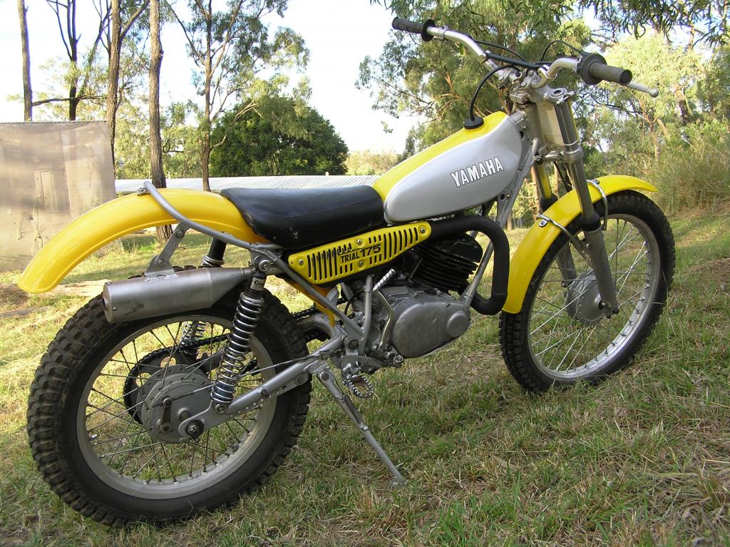

Update.
Wow, I didn't realize how long it has been since I started this thread. I finally got to add the extensions to my swing arm. Actually, I picked up a second swing arm so I now have both the standard and longer one.
I cut off the old ends and added the extension pieces I bought from Shedworks. Also cut off and rewelded the mount for the brake plate rod. I think this added 1.5" to the length. Installed longer chain.
Rode for a couple miles last weekend and it seemed to work much better. More compliant, less twitchy. Also better for starting from a stop going uphill. It definitely made the front end feel heavier as expected. Overall, I am happy with the change.
