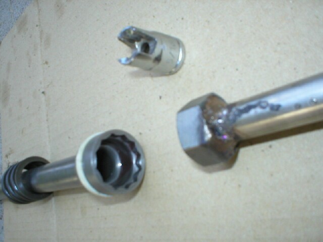

kevin j Posted May 17, 2005 Report Share Posted May 17, 2005 I made a tool from a socket I believe. If I can find it I post a pic tonight. 175 is differnt from 250 Impact gets it loose usually, but I am cautious about tightening back up with the impact unless you are familiar with the gun and how tight is will be. k Quote Link to comment Share on other sites More sharing options...
kevin j Posted May 17, 2005 Report Share Posted May 17, 2005 Didn't find the tool, but found a picture of it. Will paste below. If you have stock TY175 forks, there is a flat sided aluminum nut/tang on top of the internals. Tool I made from a 3/8 drive 5/16 square socket with the sides ground out. After the picture was taken I welded it onto a length of stainless tubing so it could not come off the socket extension while buried down inside the fork. The tool at bottom of picture is for TY monoshock front forks. The top of the internal parts is shown bottom left. I beleive the hex nut was 7/8 (22mm?) just welded to a length of stainless 1/2 OD tubing with a 3/8 socket welded to top to accept a ratchet. From my notes files: FORK SEALS FOR TY250 a/c/d 74, 76-77 ARE34 MM X 46 MM X 10.5 MM. Garter spring on seal side, plus std lip wiper outside. Aftermarket K & S, Taiwan bought on ebay. Listed as many Suz TS & TM 250. Yam YZ 100 & 125, MX125, DT250 of 70 Quote Link to comment Share on other sites More sharing options...

trialsrfun Posted May 21, 2005 Author Report Share Posted May 21, 2005 Thanks folks job done, we made a holding tool from a piece of tube with two metal strips one welded each side, clips came out fairly easily forks seem oiltight now. Quote Link to comment Share on other sites More sharing options...
