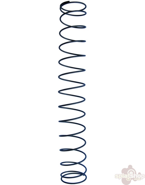

copemech Posted December 12, 2012 Report Share Posted December 12, 2012 Which bike and carb? Are you talking Lighter or Smoother? A bearing will not neccessarily make it lighter, as you gotta trim off 2-3 rungs off the return spring to do that. Carefull though, as it is less likely to return if any dirt sticks it! Quote Link to comment Share on other sites More sharing options...
lineaway Posted December 12, 2012 Report Share Posted December 12, 2012 You can cut a coil or two off your slide spring to give it a light feel for no money spent. Careful not to cut too much. Quote Link to comment Share on other sites More sharing options...

copemech Posted December 13, 2012 Report Share Posted December 13, 2012 by cutting about 2-3 rungs of is there a big chance of it sticking or is it very small also found out about the jitsie throttle cables - "the jisie throttlecables have a teflon coating inside the cable housing elimenating all possible friction and results in an unmathched throttle feeling" sounds good this and cutting a few rungs of the spring will surley make it feel sooo nice and light jitsie cable now on my list. thanks, ben Ben, none of this is approved, it is all experimental to individual taste and results. The factory spring is made to do the job in all but the worst cases of contamination. As an example, some pro riders may choose to do things like this, yet it is also common for them to clean carb and airbox after every ride! The maintenance becomes more critical you see, as to Not have issues. If indeed you are bound to try this, then take all to heed! The springs are wound with a finish wind on the ends, not sure the name for this, but the last wrap of spring is only half effective because it is wound flat. So to count, start at the end, go one turn, then two, and that is where you snip the spring. The spring will no longer have the flatwound end, thus I believe the (shop) end should go towards the top as to not interfere with anything. Two rungs will make a little difference, three will make more. I would not go beyond that. Add, I do not support any of this nonsense! (although I may yet do my own on the new bike when I get around to it) Quote Link to comment Share on other sites More sharing options...

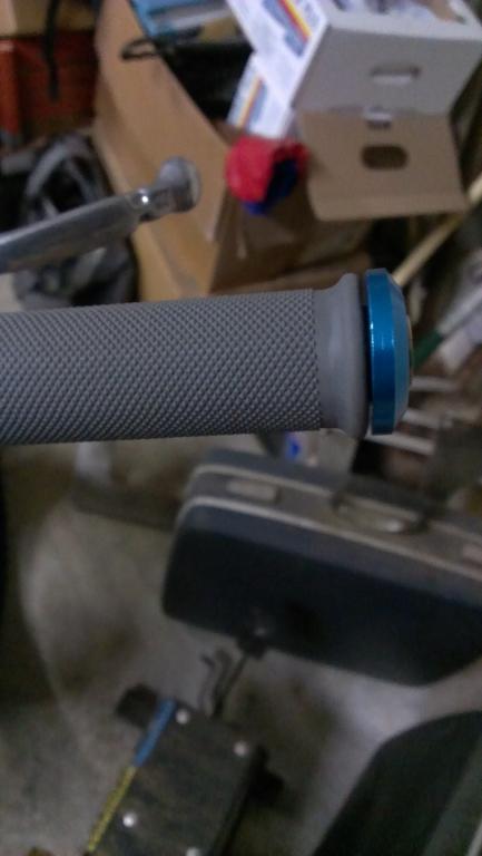

axulsuv Posted December 13, 2012 Report Share Posted December 13, 2012 Ben ; I run a aluminum domino throttle tube with a Hebo bearing bar end plug , Makes for a much smoother/ more consistent throttle feel for me . Along with a well routed and lubed cable . (wd40 works fine )... Glenn Quote Link to comment Share on other sites More sharing options...

tankygsy Posted December 13, 2012 Report Share Posted December 13, 2012 Don't cut your spring. You will gain nothing except for a spring that is inefficient. Shortening a spring by cutting its coils off actually increases the spring rate! I can't understand why anyone would want to make a throttle lighter, they are light enough! You must have a cable problem or done other issue. How does the feel of your throttle compare to other bikes of the same type? Quote Link to comment Share on other sites More sharing options...

jse Posted December 14, 2012 Report Share Posted December 14, 2012 I run a Hebo bearing throttle, use powered Graphite (lock lube) in the tube and Silicone spray inside the throttle housing. Always very smooth and the bar ends are quite stout and saved my grips several times. I never ran the standard bar ends, although I would have liked to, because junk always got in the throttle tube but the bearing ends seal out dirt very well. Quote Link to comment Share on other sites More sharing options...
copemech Posted December 14, 2012 Report Share Posted December 14, 2012 (edited) Don't cut your spring. You will gain nothing except for a spring that is inefficient. Shortening a spring by cutting its coils off actually increases the spring rate! I can't understand why anyone would want to make a throttle lighter, they are light enough! Debate this all you like, as I am no springologist, yet I can tell you a couple things. The spring rates are set by the carb manufacturer. There are differences. As example, I find the rate on my new bike with a standard dellorto to be somewhat greater than my old bike with the Oko or Kiehin installed. Not of great importance, yet it is there, which is why I may decide to soften it a bit. The rate of the spring is a constant throughout its length and increases with compression. In a captured spring with a lot of preload such as this, shortening does reduce the total force of the spring at a given distance traveled as you have reduced the preload and the total force required.. We are talking force here, not smoothness. For smoothness, the majority of the other tips apply. I have considered the bearing ends such as the Hebo that Axulsuv refers to, and they look good on paper. Question here is, does the endcap rotate with the throttle? If so, I find that a big turn off, as one of the things I dislike is a throttle that will get pinned in a crash, as it what happens with a standard throttle and grip exposed to the ground with a standard grip. I prefer a fixed bar end to hopefully prevent this, and it has worked soo far. Yes, I do run a bit of oil on the tube, and yes dirt may get in, but not for long as this is just another occasional cleaning based upon conditions and any indication of roughness and BEFORE damage occurs to the bars and such. My tolerances on setup are very tight to prevent this dirt entry. As we are more dry here, dust is more the issue. The pic will show about 2mm clearance from the grip to the bar end. What it does not show is the 1mm clearance to the actual throttle tube. Given that these components are new, they work very smoothly, and will for a long time if taken care of. Edited December 14, 2012 by copemech Quote Link to comment Share on other sites More sharing options...
