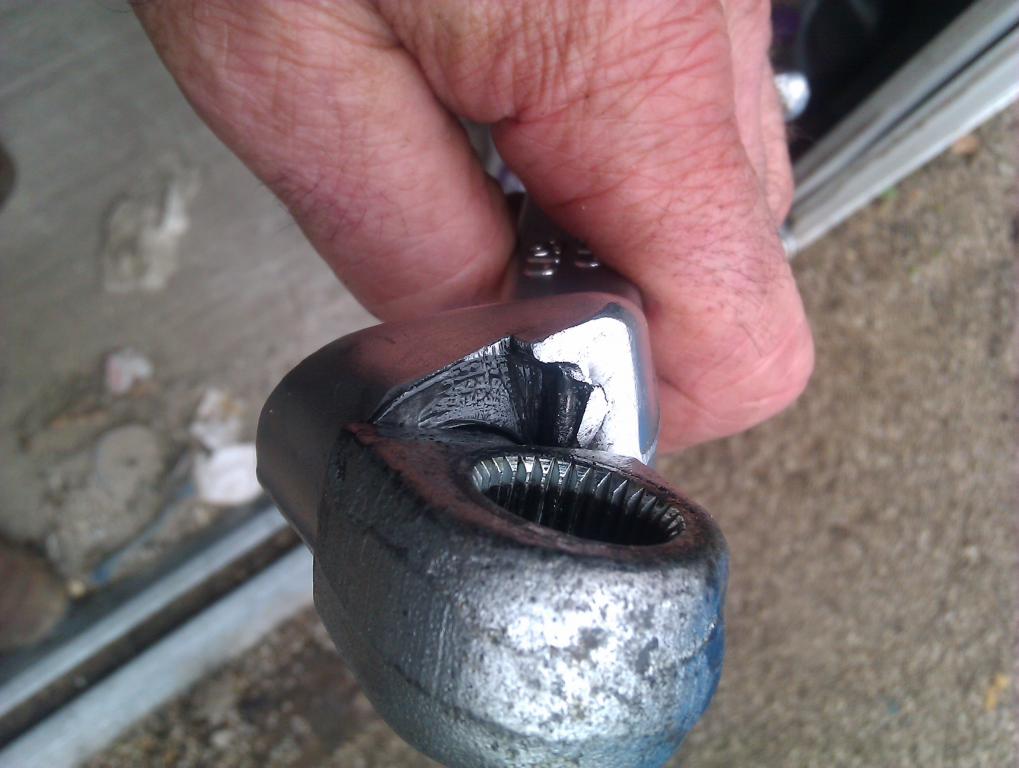

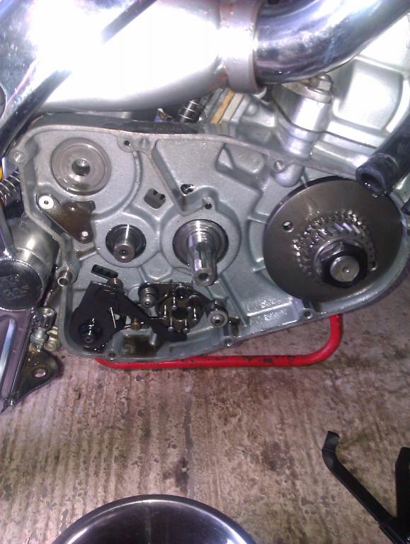

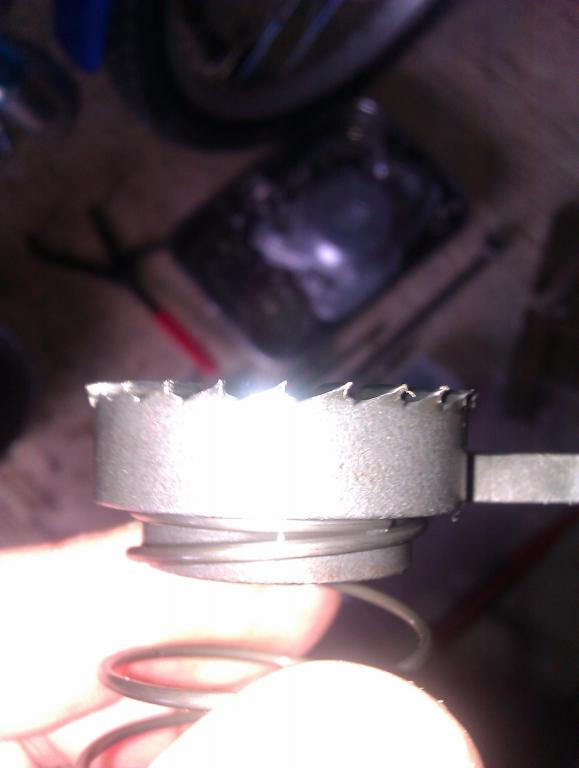

shyted Posted June 13, 2013 Report Share Posted June 13, 2013 Stripped the kick start mechanism today . Knew problem had started a couple of weeks ago . But as it goes after thirteen years ,it says something for gasgas quality and now it's out with the problem to prevent failure . Check out the pawl , looks like a hole saw on the tips . On the first pic you can see how the surface has gone on the kick start . This put the kick lever at an angle towards the back ,caused my foot to slip off and put a nice hole in the back of my knee as the compression stroke fired the lever back . That made me say ouch a bit . Then the odd time the lever would miss align and skip down a little . That's enough prompting for me . You would not believe how much crap that's put in the oil . 1 Quote Link to comment Share on other sites More sharing options...

shyted Posted June 14, 2013 Report Share Posted June 14, 2013 That looks highly unpleasant. Yes Zippy . just caught it in time by the looks of things . Quote Link to comment Share on other sites More sharing options...
zippy Posted June 14, 2013 Report Share Posted June 14, 2013 Yes Zippy . just caught it in time by the looks of things . Yep sure did....................... but of course I would have waited until it was properly broken before repairing it (you know broken kickstart lever and shaft, cracked clutch cover, etc... That way I could spend more time and $$ on it to get it fixed. Wow I can be really stupid sometimes. Quote Link to comment Share on other sites More sharing options...
