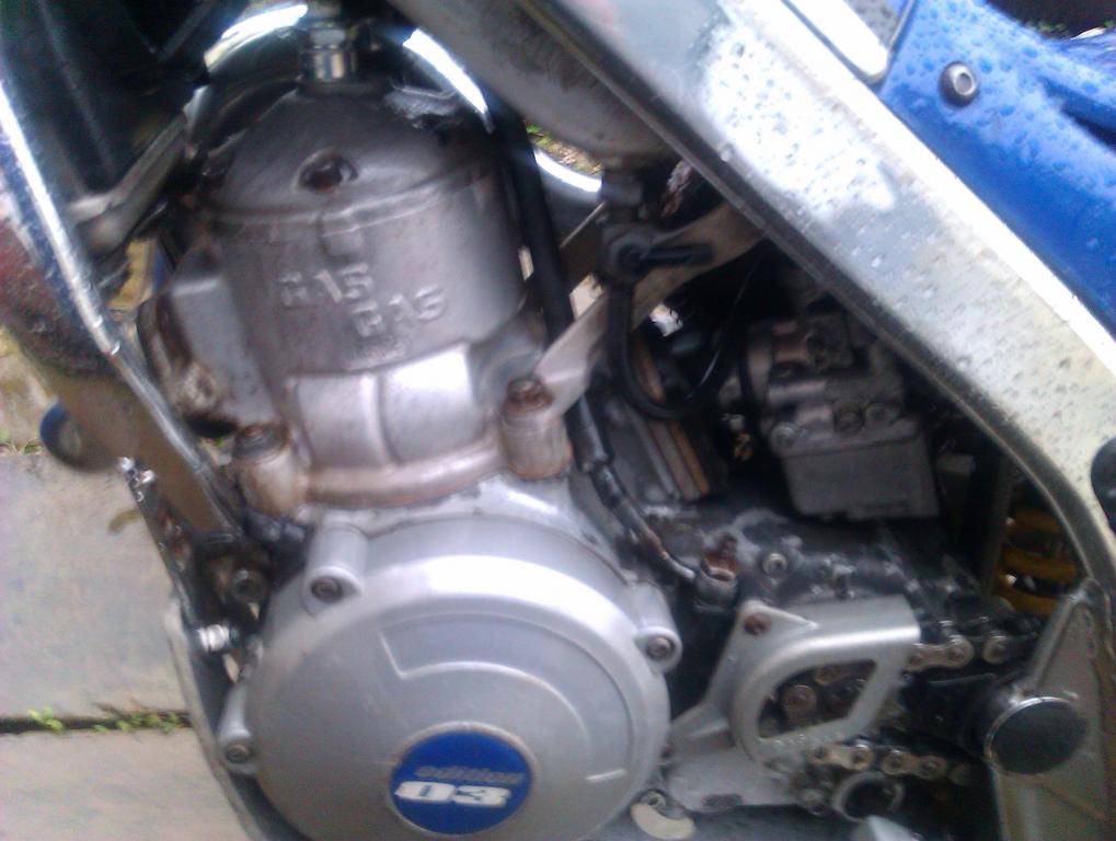

shyted Posted February 8, 2014 Report Share Posted February 8, 2014 (edited) At last got home!so today on my GasGas fired it up till it got hot and fan cut in then had a quick blast round the garden. Then to my mates GasGas, i spent 2 hrs bloody cleaning it. He bought this 03 250 Edition blind,even though i told him not to . If he spent a grand on it, he still wouldn't have a neat bike.It's rattling it's tit's off and quite frankly ain't worth a blow on a Rag and Bone Mans trumpet ! He paid £900 for this thing and every metal surface except the fork legs are goosed. I know i'm choosy but check out the spray painted body work and how corroded the engine cases are . The back shock is leaking and the linkages have more play than soft Mick! Chain and sprockets worn past reliable function. Funny though the front brake works a treat. My self even if i'd traveled to Outer Mombasa to view this bike i would have walked away.If the person who owned this bike is reading this you want stuffing for passing this sort off trash of as Good condition for age . To my Mate,well i told you so! Edited February 8, 2014 by shyted 1 Quote Link to comment Share on other sites More sharing options...
tltel Posted February 9, 2014 Report Share Posted February 9, 2014 looks like its been ridden in sea water, or just maybe kept out side. TLTEL Quote Link to comment Share on other sites More sharing options...
shyted Posted February 9, 2014 Report Share Posted February 9, 2014 On 2/9/2014 at 1:03 PM, tltel said: looks like its been ridden in sea water, or just maybe kept out side. TLTEL For the state of it tltel i'd agree but i think it look's like it's just been hosed over with a power washer with some sort of de-greaser and left wet , but whatever it's a mess. Glad it ain't mine! Quote Link to comment Share on other sites More sharing options...

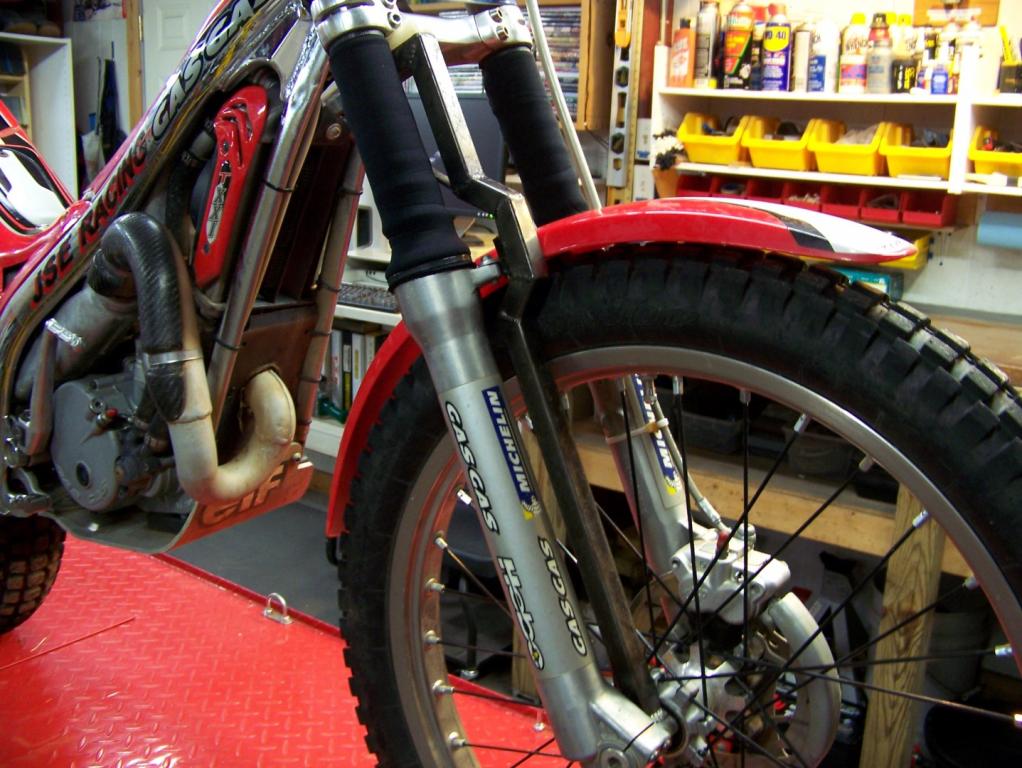

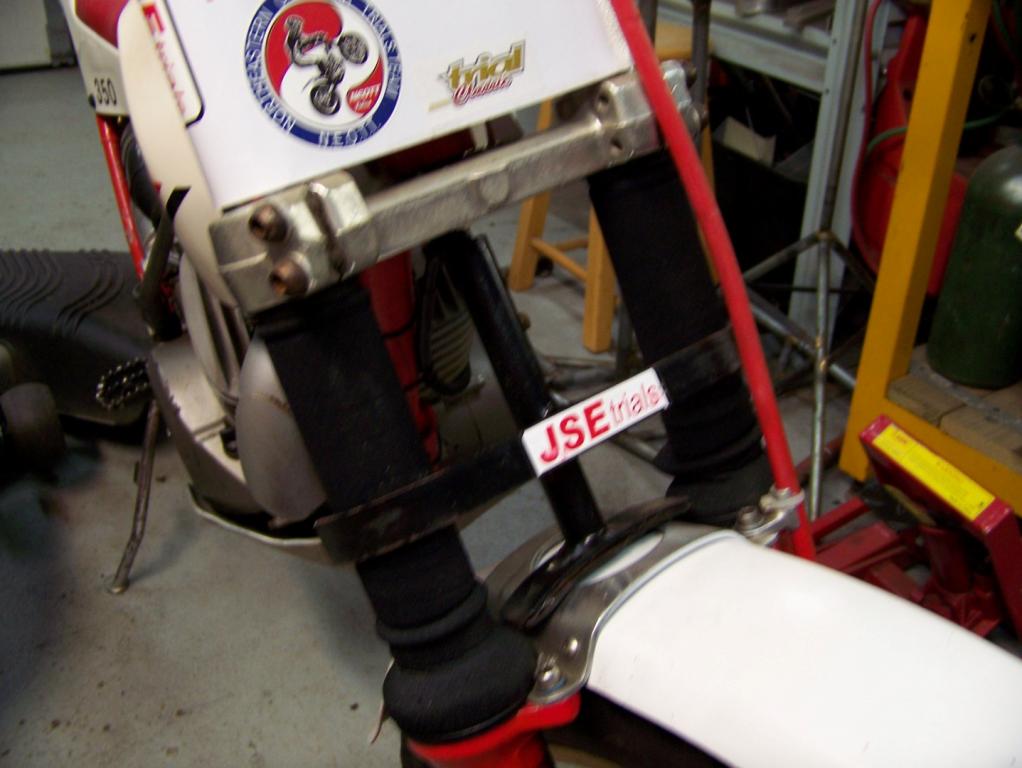

jse Posted February 27, 2014 Report Share Posted February 27, 2014 This fork brace has been giving me good service for about 12 years now: Jon 1 Quote Link to comment Share on other sites More sharing options...
shyted Posted February 28, 2014 Report Share Posted February 28, 2014 Ah jse good to see a nice tidy workshop with propper equipmentand clean work space. Also if you built that tool well done. Quote Link to comment Share on other sites More sharing options...

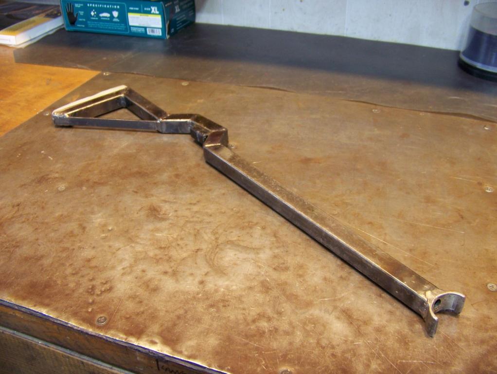

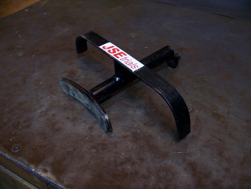

jse Posted February 28, 2014 Report Share Posted February 28, 2014 On 2/28/2014 at 12:32 PM, shyted said: Ah jse good to see a nice tidy workshop with propper equipmentand clean work space. Also if you built that tool well done. I've made braces for all my bikes since the 70's. Here's the one I use for my TY 350s. 2 Quote Link to comment Share on other sites More sharing options...

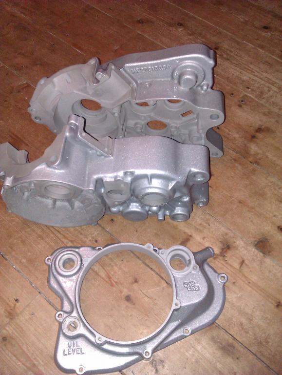

shyted Posted March 5, 2014 Report Share Posted March 5, 2014 (edited) Today for mama GasGas,i collected the cases from Triple S coatings in Bingley . They look mint in reality,they're actually metallic. Here's a picture. Edited March 5, 2014 by shyted 2 Quote Link to comment Share on other sites More sharing options...

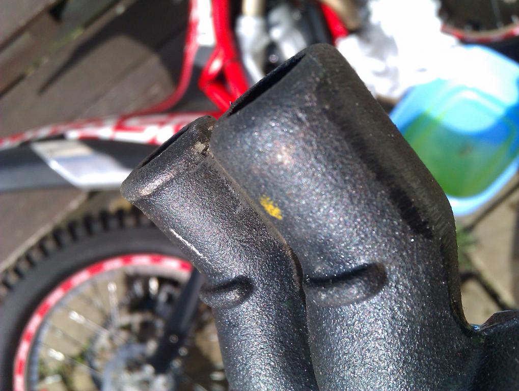

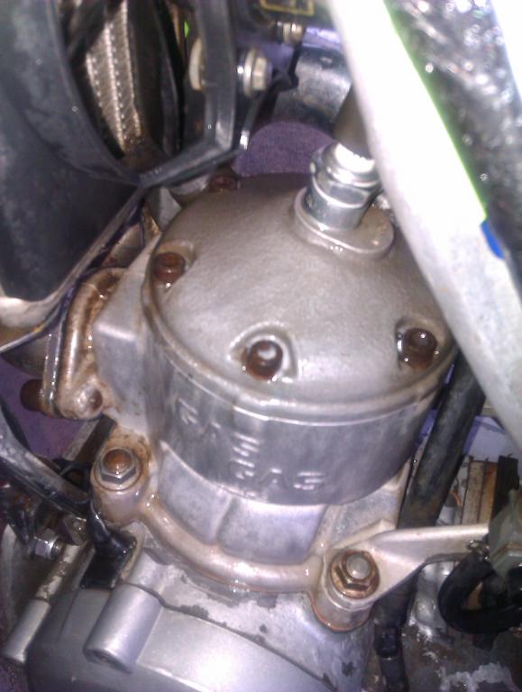

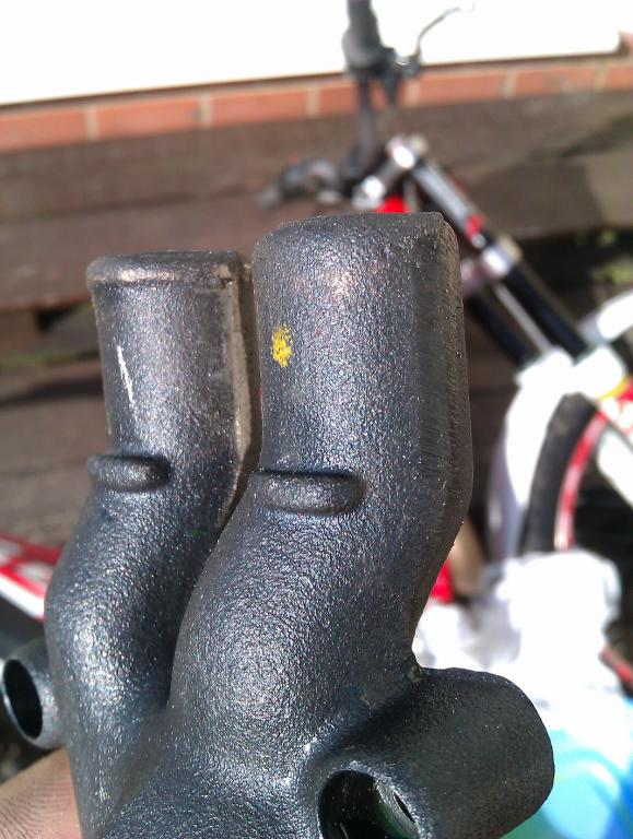

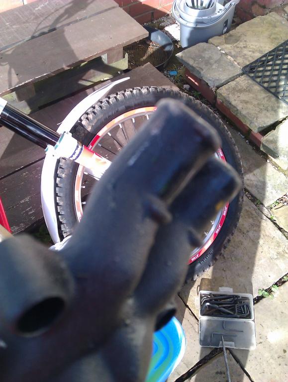

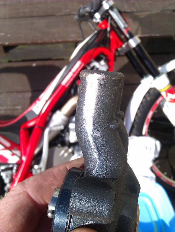

shyted Posted March 10, 2014 Report Share Posted March 10, 2014 (edited) Funny you should ask about what i did today to my GasGas,as on my new 250, i nearly had a baby on discovering a water leak! Just a little speck on the bash plate. I haven't ridden this one in anger yet as iv'e been stuck away from home yadder yadder . Other day ran it up, no problem. Yesterday just before dark noticed the drip on the bash plate . Had a quick peek, revealing water under the water pump unit.On this occasion, i held back on tearing in to it and mailed Kev at GasGas U.K should there be a recognized fault.Bit like the leak from the rear brake hose at the caliper. Any how there isn't .But this is what i found,see the pic's Not that clear,pic one, but there's a substantial amount of uncleaned casting on this spigot on both sides.Pic two is after i filed it back, pic three shows how the factory have finished the spigot with the yellow dot . The last one is so you can see that i did both sides. So should you spring a leak for no apparent reason,give this a look see. Ted. Edited March 10, 2014 by shyted 1 Quote Link to comment Share on other sites More sharing options...
