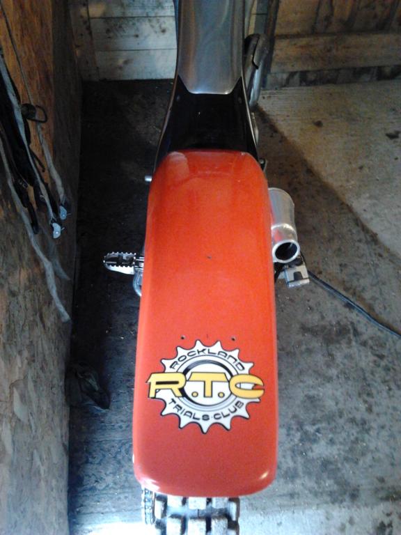

shipdamite Posted January 26, 2013 Author Report Share Posted January 26, 2013 And a pic of our new club sticker made by Christian at Crispy Designs (the club is so new, we number 3 in total ;-] .....) Quote Link to comment Share on other sites More sharing options...

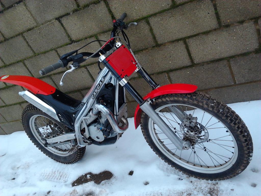

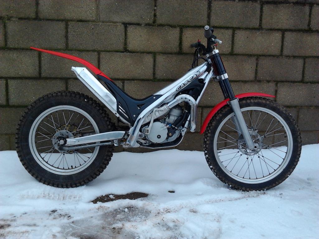

shipdamite Posted January 26, 2013 Author Report Share Posted January 26, 2013 On 1/26/2013 at 4:46 PM, shipdamite said: I would if I could Neilh - I will glady email to you? I have managed to post some pics.......... Quote Link to comment Share on other sites More sharing options...
mr neutron Posted January 26, 2013 Report Share Posted January 26, 2013 Good Job with the Pics, Andrew! And that's a VERY Nice Bike, Sir! Jimmie Quote Link to comment Share on other sites More sharing options...

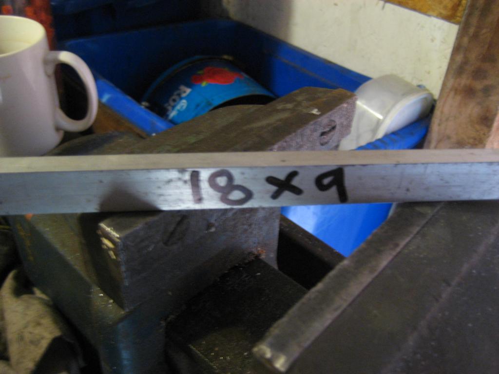

shipdamite Posted February 7, 2013 Author Report Share Posted February 7, 2013 (edited) today, I turned this.................. Edited February 7, 2013 by shipdamite 1 Quote Link to comment Share on other sites More sharing options...

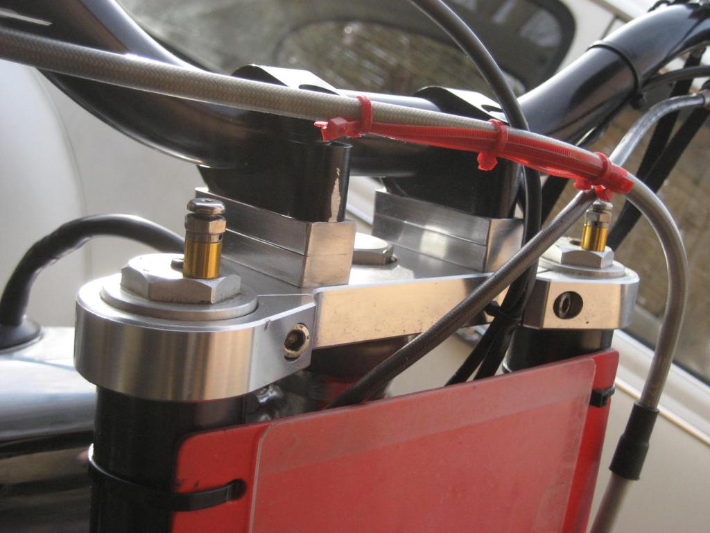

shipdamite Posted February 7, 2013 Author Report Share Posted February 7, 2013 into these bar risers. The original 'long' bolts go into the inward (back) mounting holes and some 70mm bolts are then needed for the outward (front) mounting holes - I used button head bolts. The c/c holes in the aluminium bar are 40mm. Not the most beautiful creation, but that 18mm raise allows 6' 2'' me to turn the bike a lot tighter without getting tied up - an amazing improvement............ total monetary cost was £1 for two new bolts. The aluminum was in the shed already. 1 Quote Link to comment Share on other sites More sharing options...
