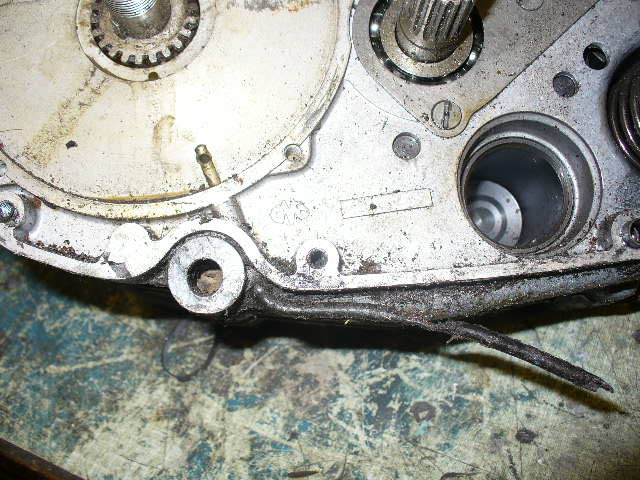

b40rt Posted December 18, 2012 Author Report Share Posted December 18, 2012 Hi lineway I have removed the small diameter pipe completely, and sealed each end so the system is redundant. (I am not referring the the carb overflows) The following pictures show the pipe . Quote Link to comment Share on other sites More sharing options...

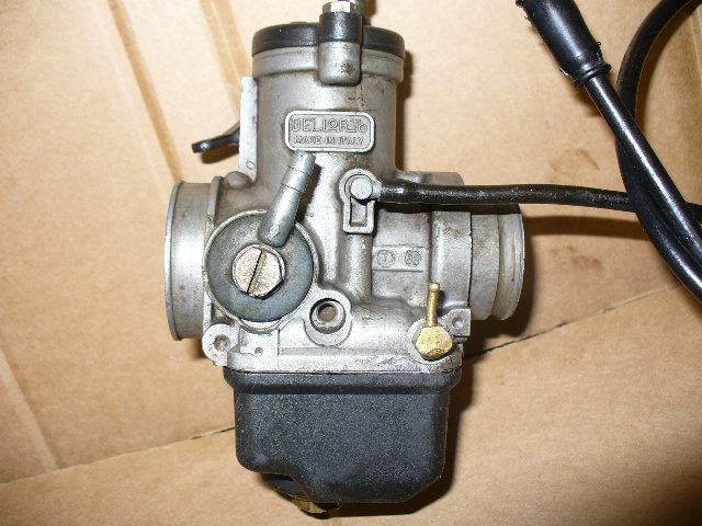

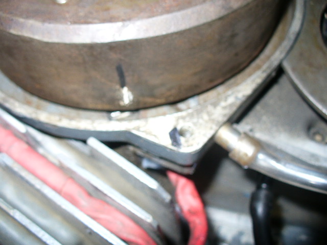

b40rt Posted December 18, 2012 Author Report Share Posted December 18, 2012 Well, checked the timing and it was about this far out when strobed, Thought I had cracked it, still the same. Cleaned the carb again, still the same. Swapped it for one off an Arpilia (petrol screw type) sorted. Thanks for all your help and suggestions, now all I need is another PHBH 26 FS carb. Ross Quote Link to comment Share on other sites More sharing options...

b40rt Posted February 13, 2015 Author Report Share Posted February 13, 2015 Resurrection - as said, solved the problem by borrowing a petrol screw Dellorto from another bike and ran it till about a month ago. Decided it was time to replace carb and return the original to the donor bike when the new one turned up. I expected to notice a real difference between a brand new carb, and a 25 year old one. Virtually none, which was a pleasant surprise, and goes to show that they are/were very good quality. (this is contrary to the opinion voiced on a well known site, which claimed they wear significantly in a year) 1 Quote Link to comment Share on other sites More sharing options...
iconic558 Posted February 14, 2015 Report Share Posted February 14, 2015 Good news... my bike came with a receipt for a new Dellorto, I was surprised how very reasonable the price was compared to, for example one new carb for a 1992 Suzuki GSXR750 of which they made hundreds of thousands Mikuni BST's 1 Quote Link to comment Share on other sites More sharing options...
b40rt Posted May 24, 2015 Author Report Share Posted May 24, 2015 Well, checked the timing and it was about this far out when strobed, timing 002.jpg Thought I had cracked it, still the same. Cleaned the carb again, still the same. Swapped it for one off an Arpilia (petrol screw type) sorted. Thanks for all your help and suggestions, now all I need is another PHBH 26 FS carb. Ross Just checked timing on another "new to me" rotax, and the timing is almost exactly the same amount out. Is this the heel on the points wearing, or someone trying to calm it down ? Any suggestions. Quote Link to comment Share on other sites More sharing options...
