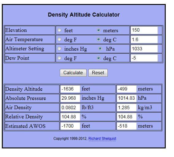

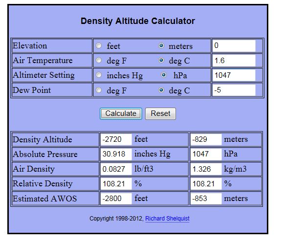

copemech Posted January 17, 2013 Author Report Share Posted January 17, 2013 On 1/16/2013 at 4:43 PM, slapshot 3 said: Been busy in here today but at a quick look at some of the books...as you assume it links to pressure the way air density changes relative to air temp at a standard atmosphere. You also have to look at Orthobaric Density which is relevant to the densities of the co-existing state (liquid, solid & gas) at a given temperature and atmosphere.... Too much thinking here Copey, can you not use millibars or Hectapascals like us normal folk!!! I'll keep digging On the plus side....office IT didn't block me today!!! Donald, if I took this to millhecktowhatevers and Cunni, it looks more like this first one, then adapted to sea level by standard lapse rate looks more like the second!! Quote Link to comment Share on other sites More sharing options...
