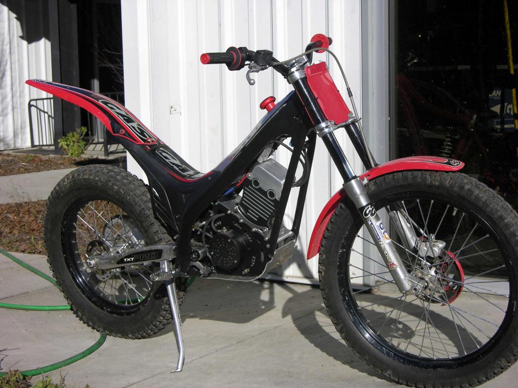

nostroke Posted February 4, 2013 Report Share Posted February 4, 2013 I bought a used Gas Gas TXT 200 and converted to electric. I used a Briggs and Stratton E tek motor direct drive (11 / 60) gearing with a 428 chain / sprocket that I made. I use a battery pack made from RC car LiPo cells, 42 volts, 20 amphour. Am loving it, ride it every day in a residential area with no complaints. The bike weighs 145 pounds and makes just under 20 HP, lots of torque. 5 Quote Link to comment Share on other sites More sharing options...
frogger Posted February 4, 2013 Report Share Posted February 4, 2013 Wow nostroke, fantastic conversion! Any videos of you riding it? WOuld love to get an idea how the power kicks in and what it can do. Great job! Quote Link to comment Share on other sites More sharing options...

nostroke Posted February 4, 2013 Report Share Posted February 4, 2013 I usually ride the bike for about 1 hour before I can detect any power loss, which means its done. I could add more battery capacity but I really like the light weight and my old body is pretty hammered after 1 hour. anyways. I've built a lot of electrics, cars, bikes, trucks, etc and the first question is ALWAYS how long will it run. And there is never an easy answer because,just like a gas engine, it depends a lot on how hard you ride. But for me anyways, the run time is more than adequate, but I don't compete. There are other issues that would need to be addressed if one wanted to run with the big dogs. But as you all know, there is a big gap between just riding for fun in your back yard VS a pro event. For instance, I did not concern myself with water issues. The motor is quite exposed which helps with air cooling but would certainly have issues in competition. When I look at the designs done by Scorpa and GAS GAS, they have clearly done a better job of making their electrics water (and idiot) proof. I'll try to get a video up showing its performance. I think its pretty compelling using electrics for practice bikes. It will wheely up any hill very easily. Before I converted it, I rode it for a day and was reminded how incredibly hard it is to modulate the clutch throttle and brakes simultaneously. The electric is very easy in this regard. Quote Link to comment Share on other sites More sharing options...

nostroke Posted February 4, 2013 Report Share Posted February 4, 2013 gwhy-sounds like you may have cells similar to mine, which are not really RC car cells. These are 10 AH lithium cobalt pouches. I made up two mini packs of 10S (~42V end of charge). I parallel these when I plug them onto the bike's harness. I was originally going to use 3 of these mini's in parallel for a 30 AH system, but these cobalt cells deliver the full pop, peaks of 20C (400 amps total). The down side is that these are also the cells that grounded the Boeing Dreamliner I think, ie, they can catch fire and you have to keep that in mind when storing the bike.Why they (Boeing) would chose these hot rod cells for an airplane is beyond me, but they rock for performance. Quote Link to comment Share on other sites More sharing options...
