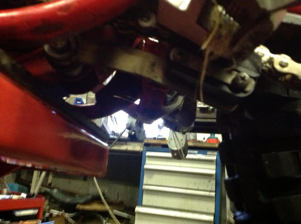

ikb Posted February 26, 2013 Report Share Posted February 26, 2013 No they didn't have one from new, you could get one that bolted on to the engine. I fitted a universal one from trials bits on mine, it bolts on to the rear engine mount bracket with a suitable spacer. Quote Link to comment Share on other sites More sharing options...
ikb Posted February 26, 2013 Report Share Posted February 26, 2013 Quote Link to comment Share on other sites More sharing options...
johnwayne22 Posted February 26, 2013 Report Share Posted February 26, 2013 No they didn't have one from new, you could get one that bolted on to the engine. I fitted a universal one from trials bits on mine, it bolts on to the rear engine mount bracket with a suitable spacer. ahh, that explains it, thought i was losing the plot for a while. Definatly makes sense to have one.reckon i'll fit one there too, will be much more effective. cheers for that. Quote Link to comment Share on other sites More sharing options...
