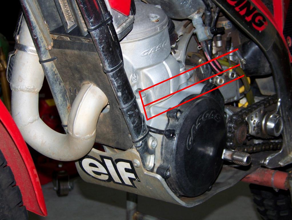

sting32 Posted January 30, 2013 Report Share Posted January 30, 2013 Yeah Lazer that is it. I mentioned it, I might have confused some, at the "deflector at the opening." FWIW! Caution, You DO NOT want to restrict the air. IMHO, you dont want the airbox sucking in air from anywhere else except under the tank! I think I have turned the little flap on the bottom over each time I take the airbox off. when I know it is going to be a wet day, on one bike I added another layer of "plastic milk-jug plastic flap" 3-4ths the width of the original flap, helping to keep the flap closed, I am glad as hell I did, I rode into a creek, that went up to the tank for just a second (hole) and I didnt kill the bike, like another did, in Tishomingo. Keep that bottom hole almost sealed... if you hit top of cylinder high water, water rushes into that airbox like a ship with the hole in the bottom, plus the carb opeing is only just above your cases. Here's the waterlines of your aribox opening, roughly... Quote Link to comment Share on other sites More sharing options...
