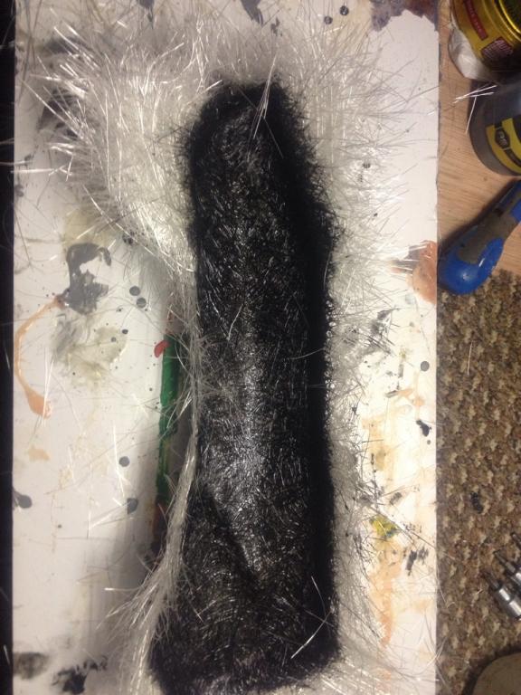

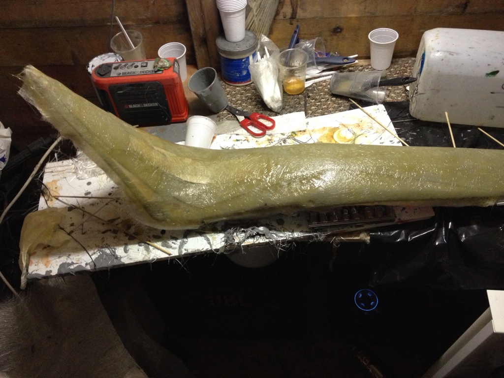

closeybeta2011 Posted January 27, 2013 Report Share Posted January 27, 2013 i had an idea to make fiber glass exhaust guard so i molded an old guard just to try it out then made a few off that mold then i had a better idea carbon fiber ! so ebay i went and bought 1m x1m carbon fiber cloth so had a better idea again as in the last pic i snapped my rear mudguard yes you got it so i made a mold from a mudguard i won on the bay what do you think Quote Link to comment Share on other sites More sharing options...

pindie Posted May 7, 2013 Report Share Posted May 7, 2013 Did you use the resin for fibre glass with the carbon fibre cloth or did you bake it? Is it really stiff and sharp? Watch your inner thighs if you launch it matey. You don't want to end up in the news as "trials rider loses leg in failed hill climb". That would be a bummer. Quote Link to comment Share on other sites More sharing options...
