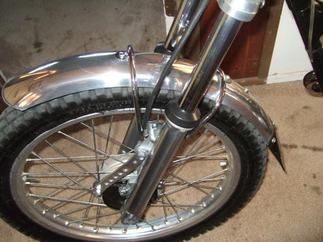

tony283 Posted January 29, 2013 Report Share Posted January 29, 2013 OTF, that set cost $75 off ebay complete with yokes and stem. Of course in the USA we can use anything up to 1974 for Ahrma and ITSA. No restraints on frame, or carbs with our ITSA trials. Tony Quote Link to comment Share on other sites More sharing options...

old trials fanatic Posted January 29, 2013 Report Share Posted January 29, 2013 OTF, that set cost $75 off ebay complete with yokes and stem. Of course in the USA we can use anything up to 1974 for Ahrma and ITSA. No restraints on frame, or carbs with our ITSA trials. Tony Bloody hell you yanks are so lucky. The carriage alone would cost more than that over here. Id be amazed if you could get them in the UK for under £300 and all that for a set of forks that would be "illegal" at a lot of clubs.Obviously much easier and cheaper in the US with their rules. Quote Link to comment Share on other sites More sharing options...
