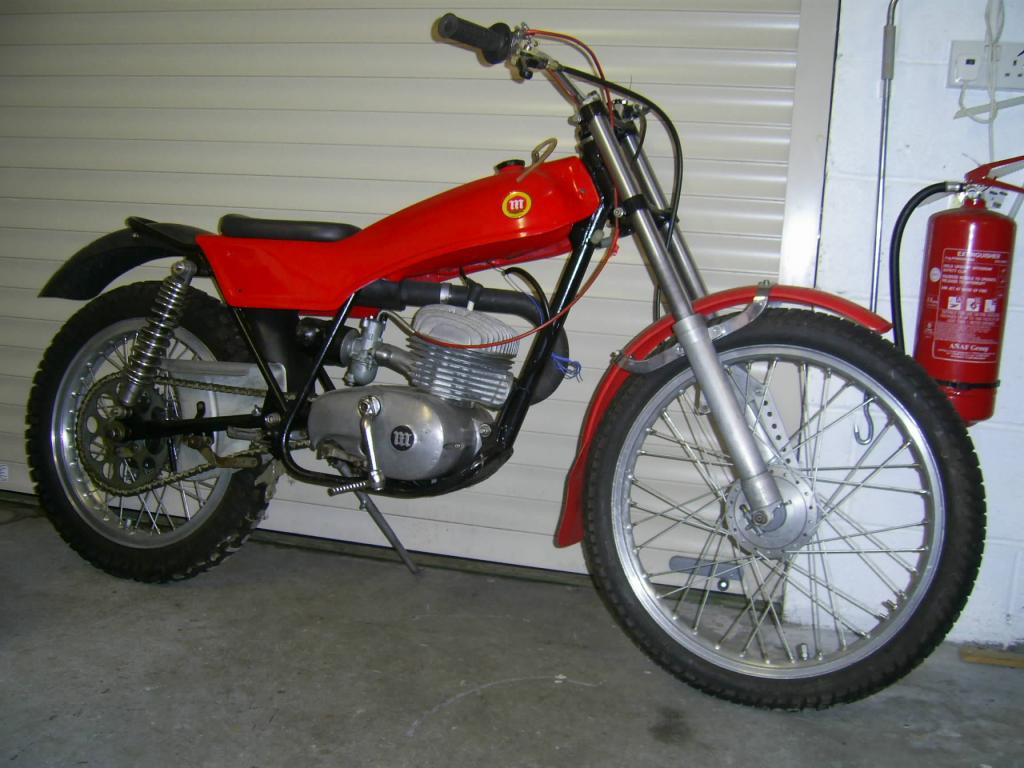

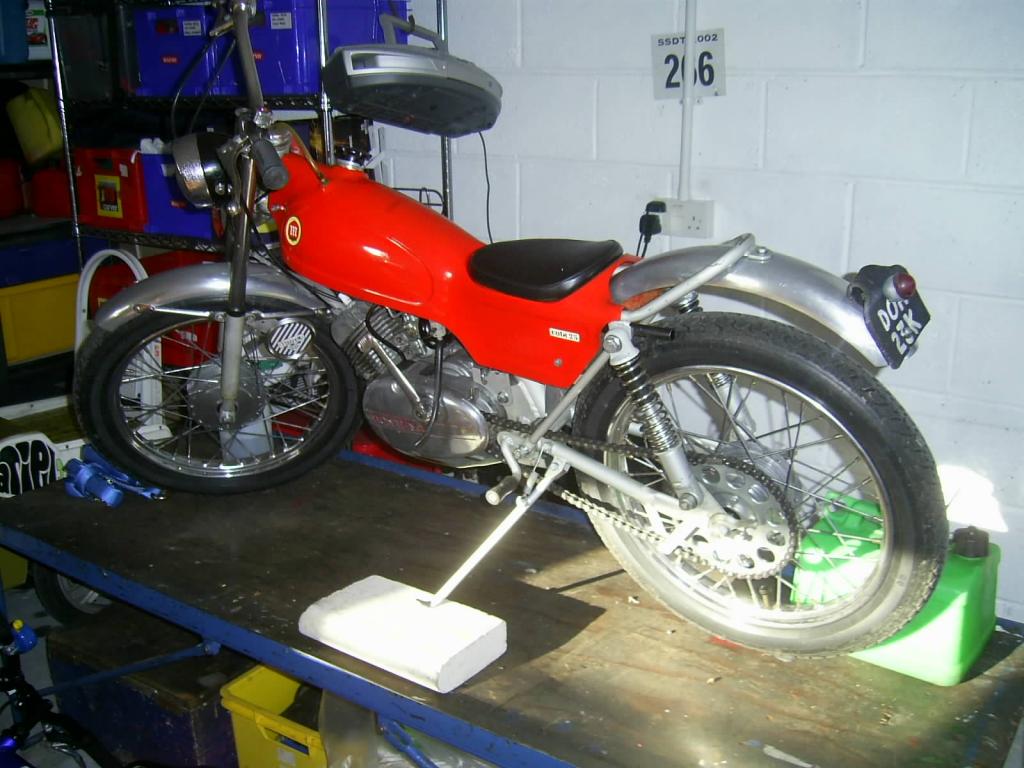

sparks2 Posted February 5, 2013 Report Share Posted February 5, 2013 I've joined the Early Cota Club. What da ya think. 1 Quote Link to comment Share on other sites More sharing options...
chris_ Posted February 5, 2013 Report Share Posted February 5, 2013 Lovely bike. Congratulations! Quote Link to comment Share on other sites More sharing options...
2stroke4stroke Posted February 5, 2013 Report Share Posted February 5, 2013 Very smart. You will no doubt be aware of the care required when starting these earlier models with the RHS gear lever. I recall one at the start of the SSDT at Gorgie cattle market. The thing gassed up and would not start so the rider gave it a really good kick with the throttle wide open - needless to say it fired at full bore just before the starter lever slammed the thing in to gear - he took away the starter's table and sent the gent flying. Rather early for a five. Quote Link to comment Share on other sites More sharing options...
jon v8 Posted February 5, 2013 Report Share Posted February 5, 2013 Far too smart - yer banned !! Gives me more encouragement to get on with mine. Two questions,first did you fit the chain tensioner,and second what model Colchester is that ? Quote Link to comment Share on other sites More sharing options...

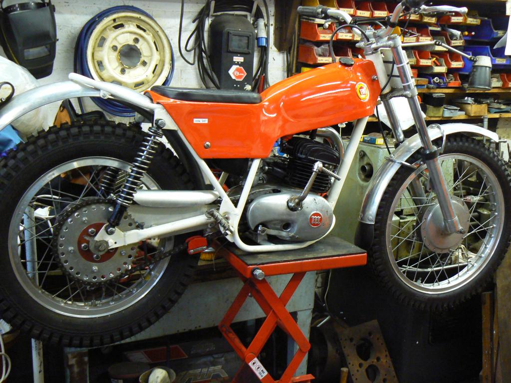

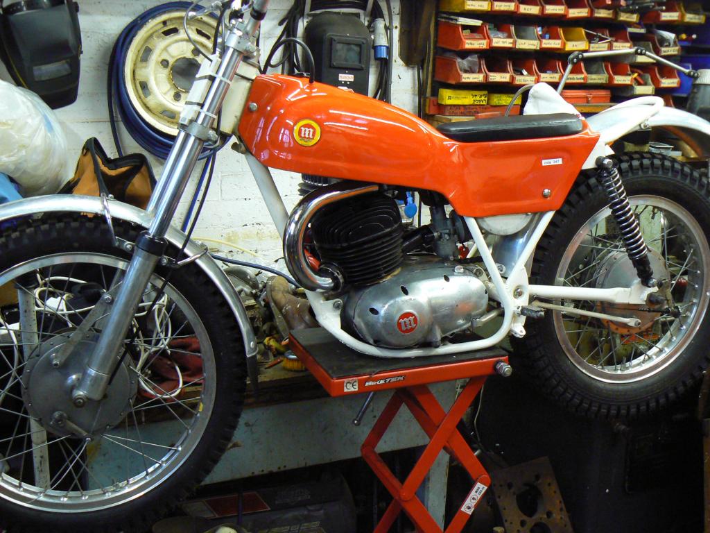

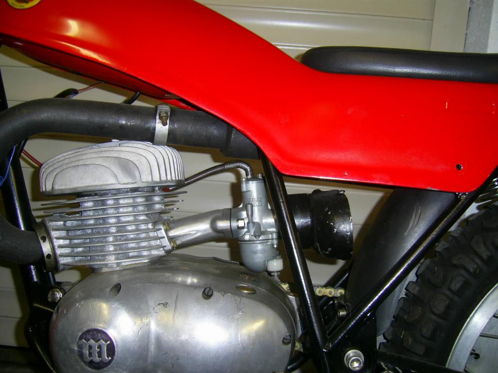

supermotoscot Posted February 5, 2013 Report Share Posted February 5, 2013 Hi I may be eligible for early Cota club. See pics. Got this 247 a couple of years ago, but only now getting round to doing something with it. I think it is a Mark 2, so frame should be white. Also need to get correct air filter and mudguards (and turn forks round!) I would welcome any advice on correct spec. This 247 is to accompany the 3 off Cota 25s that we have - pic of earliest one attached, Can anyone tell me colour code for tank and frame on these Cota 25s? PS Is there a Cota 25 forum? Quote Link to comment Share on other sites More sharing options...
chris_ Posted February 5, 2013 Report Share Posted February 5, 2013 Supermotoscot, it looks like a mk2 from 1970 (the frame number should be between 1800 and 2505). The tank is a later one, yours should have one like the tank on sparks bike at the top of the thread. The air filter is the right one, it is just missing the cover. I have got some colour codes somewhere, so I will have a look to see if I can find them. The 25 looks great, I would love to get one for my youngest, but I am not aware of a dedicated 25 forum. Good luck with the project Quote Link to comment Share on other sites More sharing options...

sparks2 Posted February 6, 2013 Author Report Share Posted February 6, 2013 (edited) Far too smart - yer banned !! Gives me more encouragement to get on with mine. Two questions,first did you fit the chain tensioner,and second what model Colchester is that ? Banned !! ........ Banned !!!!! ............ Reminds me of the time I was banned from.................. The Computer Club, a personal tragedy at the time but I got over it. Yes, you should get on with yours, they are a good little bike, I could say almost better in some respects than another well known Spanish brand begining with B. Don't forget we are not a million mies away from the 50th anniversary of the Cota's introduction. Q1. Yes, weld a bracket to the lower frame and modify a Bultaco/generic tensioner. Q2. Student. A question the other way. Jon, did you recover your reg number? --- ( I think it was you, asking the VMCC). On mine, a previous numpty binned all the paperwork AND the plate, then couldn't assemble the gearbox properly before moving on. My guess would be that the bike was used on the road in the 70's and/or 80's so will be on the DVLA comp. So I would say that any DVLA VIN check will throw up the correct 'H' suffix registration number. Suggested best course of action ........ anyone ????? Regards Sparks Edited February 6, 2013 by sparks2 Quote Link to comment Share on other sites More sharing options...

supermotoscot Posted February 7, 2013 Report Share Posted February 7, 2013 Supermotoscot, it looks like a mk2 from 1970 (the frame number should be between 1800 and 2505). The tank is a later one, yours should have one like the tank on sparks bike at the top of the thread. The air filter is the right one, it is just missing the cover. I have got some colour codes somewhere, so I will have a look to see if I can find them. The 25 looks great, I would love to get one for my youngest, but I am not aware of a dedicated 25 forum. Good luck with the project Chris Thanks for advice. Frame number is 21M 18xx. Need to look for a tank now - any bright ideas on this anyone! Would be great if you could get me the colour codes as 2 off Cota 25 tanks currently being prepared for painting. Donnie Quote Link to comment Share on other sites More sharing options...
