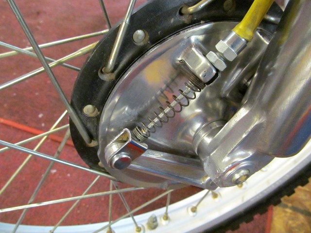

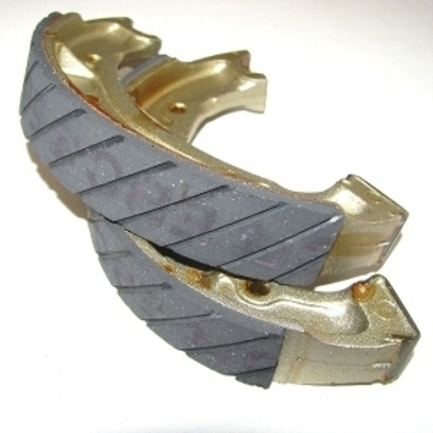

tony283 Posted February 8, 2013 Report Share Posted February 8, 2013 OTF, boy its your lucky day!! I did the same thing on the rebuilt Superglitz Yam when I fitted the TY Mono forks and yokes. The wheel that I acquired (FOC) from a friend had those 322 shoes. You can see if your wheel looks similar to the one I fitted. These wheels which fit the Mono forks are from either 80-82 IT models or from the 80/81 YZ. They all carry 322 shoes which EBC cross relate to the grooved 507G so that is what you want! Tony Quote Link to comment Share on other sites More sharing options...
old trials fanatic Posted February 8, 2013 Author Report Share Posted February 8, 2013 Tony you're a star thats EXACTLY the same as mine fantastic. Thanks mate Quote Link to comment Share on other sites More sharing options...
