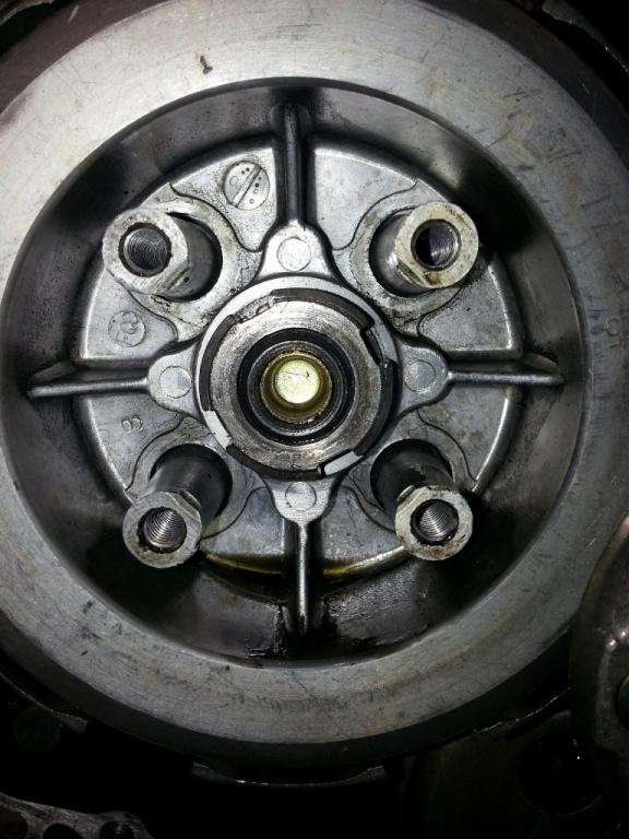

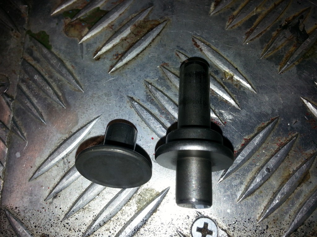

If anyone is considering this you will need to change the clutch push rod as well. The XR rod is longer but is needed so it sits in the casing correctly. You may also need to move the brass coloured plug in the main shaft. This allows the XR push rod to sit correctly by allowing it further into the shaft.
TLR on left, XR on right
Brass plug that needed to be moved in to allow the XR push rod to sit correctly.

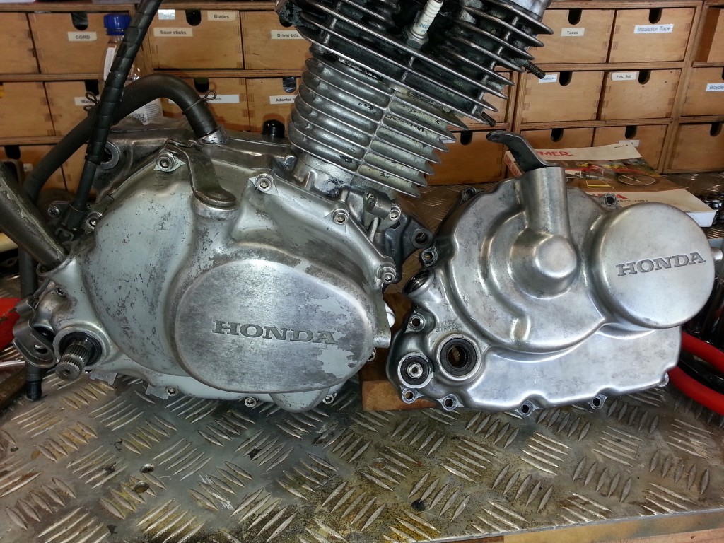

XR (left) and TLR casings

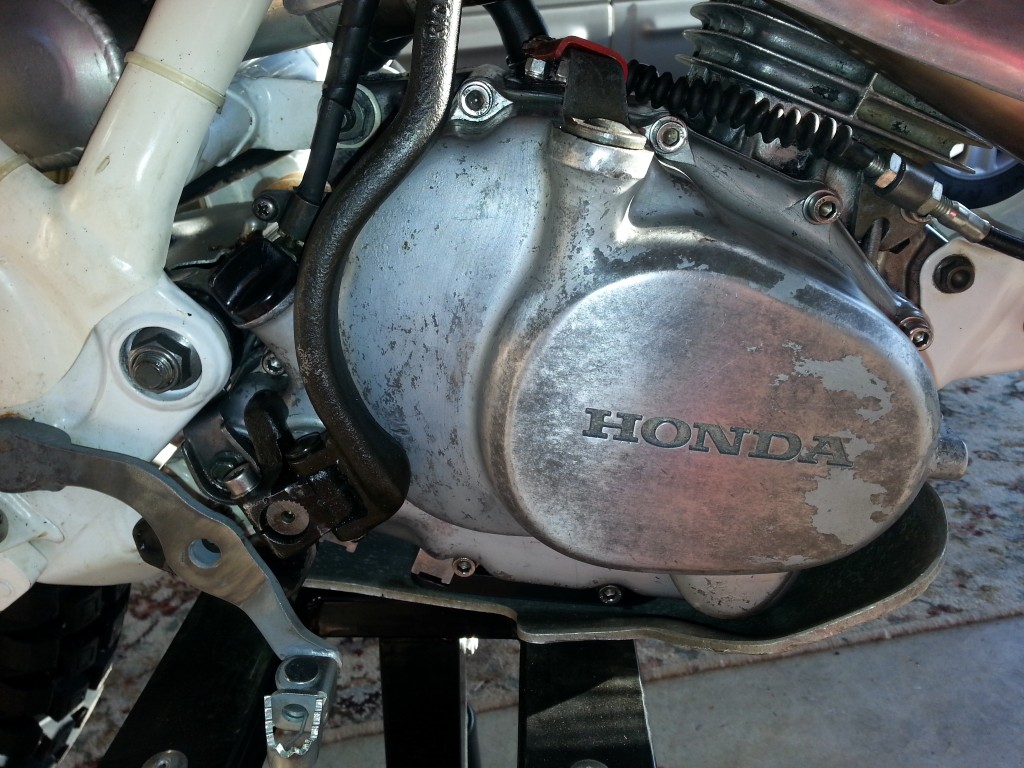

Hope these help.
