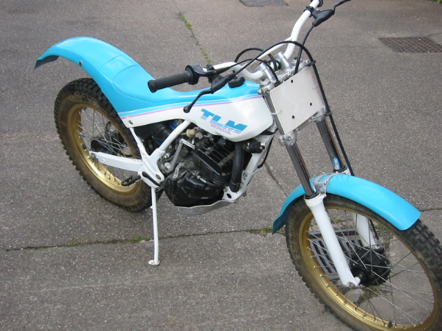

asc Posted February 19, 2013 Report Share Posted February 19, 2013 i had one it was found in a local farmers barn,had a load of paperwork with it which i got at a later date. .i think most of it went with the bike but i will have a look round ,think mcn did reveiw on it and bike mag,they were comparing it to the british bikes of the time.i was quite dissapointed when i got it sorted out as most modern pre 65's would ride much better and felt it would never be a competetive bike in a twin shock class and not eligable to ride in the british bike trials. think mine ended up in spain.got another old honda now another garage find ,i'll try and put a pic up later. Quote Link to comment Share on other sites More sharing options...
asc Posted February 19, 2013 Report Share Posted February 19, 2013 Quote Link to comment Share on other sites More sharing options...

bigmike1961 Posted May 13, 2013 Report Share Posted May 13, 2013 On 2/19/2013 at 6:54 PM, asc said: Not quite the right bike I think Quote Link to comment Share on other sites More sharing options...
