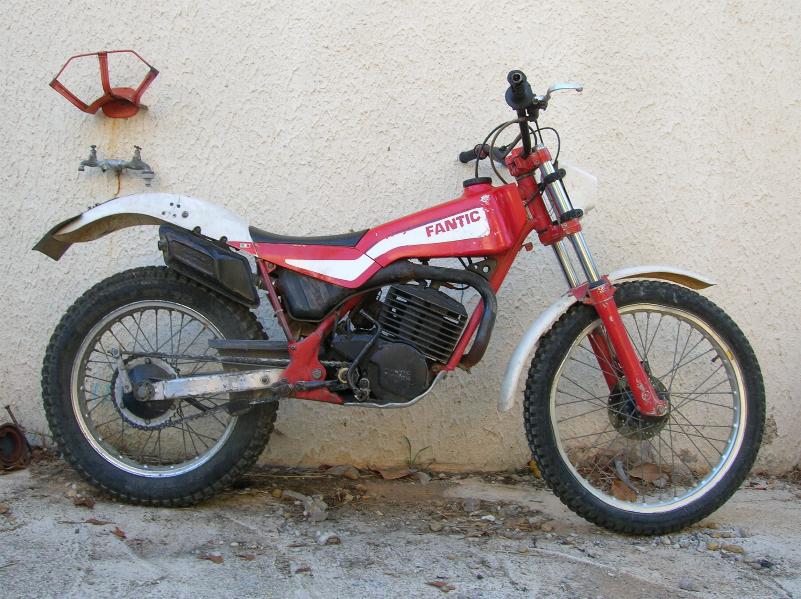

mink_man Posted February 24, 2013 Report Share Posted February 24, 2013 (edited) I have a fantic 241 that i am still restoring, anyone repacked the exhaust on one of these before, guide ? It the same box as in the picture below, its not my bike though Edited February 24, 2013 by 307133123 Quote Link to comment Share on other sites More sharing options...
blocky Posted February 24, 2013 Report Share Posted February 24, 2013 I have done one. It is a bit of a pain and takes ages but it can be done. I used a dremel cutting disc to cut the back off the silencer immediately behind the seam. The old packing can then be easily removed and the new packing put back after a good cleaning. Then carefully weld the back on again Quote Link to comment Share on other sites More sharing options...
