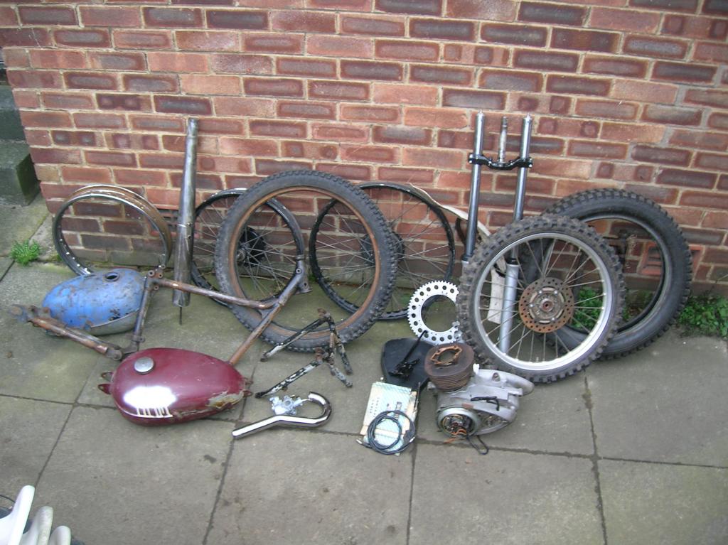

bantamsam Posted February 27, 2013 Report Share Posted February 27, 2013 Hi Guys I am new to this forum i have a cub frame and modified subframe i am basically building a cub rolling chassis with all cub parts then putting a bantam engine in as that is all i have spare any bantam engine modifications or tiger cub parts that i should buy though they will have to be cheap as i am only 15 Cheers Sam Photos so far Quote Link to comment Share on other sites More sharing options...
smelling123 Posted February 28, 2013 Report Share Posted February 28, 2013 Good luck Sam, the cub swing arm you have is what a lot of Bantam guys fit (for rear tyre clearance) so you're off to a good start. Quote Link to comment Share on other sites More sharing options...

bantamsam Posted February 28, 2013 Author Report Share Posted February 28, 2013 Good luck Sam, the cub swing arm you have is what a lot of Bantam guys fit (for rear tyre clearance) so you're off to a good start. Hi Somehow i don't think it is the wide type as my dads cub and Road bantam both have the same swing arm width and my dad says if you let the tyre down a bit it catches? Cheers Sam Quote Link to comment Share on other sites More sharing options...
old trials fanatic Posted February 28, 2013 Report Share Posted February 28, 2013 You WILL need a wider swing arm for tyre clearence with a 4.00 x 18 trials tyre. Plus usual mod is to offset the motor to the left and make a corresponding spacer ring to ofset the rear sprocket to maintain chain alignment. Quote Link to comment Share on other sites More sharing options...
bantamsam Posted March 7, 2013 Author Report Share Posted March 7, 2013 Hi How easy is it to just cut it in half and weld it? Cheers Sam Quote Link to comment Share on other sites More sharing options...
b40rt Posted March 7, 2013 Report Share Posted March 7, 2013 The frame will still be the same width, so this might not work. Quote Link to comment Share on other sites More sharing options...
charlie prescott Posted March 7, 2013 Report Share Posted March 7, 2013 Hi Guys. Hi Sam I have made my cub swing arm wider by just heating it and bending it on the Scott Ellis BSA bike. If you take a look at my web site, bsaotter.com. You will be able to read how it is done. Enjoy. Regards Charlie. 1 Quote Link to comment Share on other sites More sharing options...
