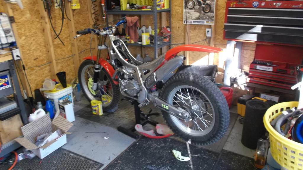

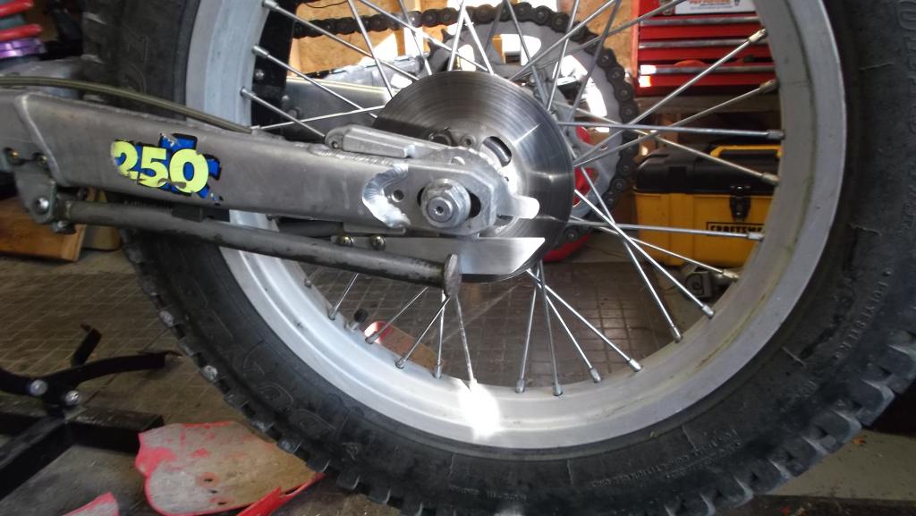

axulsuv Posted April 6, 2013 Author Report Share Posted April 6, 2013 (edited) OK .. 1/2 a hour on the bike and the mods begin ... Replace cracked , dry brittle rear disc guard with a hand made aluminum piece ... And do you guys think I would be insane if I got my neighbor/buddy/fabricator to build me a aluminum flat tank to fill the void of the stock plastic tank ? It would help make it the trials bike it would have been , if Fantic had survived a few more years ... And yeah I still have to clean my shop , but the Miata pieces are at work ! And did you notice how gasgas is copying Fantic with the in board chain adjuster ??? who da thunk it ... Edited April 6, 2013 by axulsuv Quote Link to comment Share on other sites More sharing options...
zippy Posted April 7, 2013 Report Share Posted April 7, 2013 UMMM ... It will save money on brake cleaner ? And you only have to buy the machine once . You may change the solvent annually depending on the amount of use . And you can get a cheap one at harbor freight or northern tool that will do the job just fine for home use. .... ??? It will cut down on the time you spend cleaning things , so you can spend more time with her !!! That's all I got I will give it a try........don't look goo though. HA! Clean your chain in the kitchen sink a few times, she will buy you one. (or divorce you) I was thinking of maybe buying her a dishwashing machine.... and then fill it with many parts, chain, sprockets, engine cases etc... Think it would have the same effect? I do like the inboard chain adjusters. keeps them from getting knackered. Quote Link to comment Share on other sites More sharing options...
axulsuv Posted April 9, 2013 Author Report Share Posted April 9, 2013 (edited) :( First dilemma .... Changed out the foot pegs last nite to find that one of the allen bolts had been changed to a sae bolt ! I was making use of the mass quantity of stainless hardware I've got in bins , to find that one of the bolts has been replaced with a force fitted SAE bolt !!! Now do I tap it back to the correct thread ? or do I drill it and put a heli coil into the cast aluminum frame piece ? WE are after the best repair here .... Or just retap it and see if the is enough material to do the job ? And my fabricator told me tonight to get a flush gas cap and he will do a one of a kind tank ..... PIMPING !!!! Edited April 9, 2013 by axulsuv Quote Link to comment Share on other sites More sharing options...

htrdoug Posted April 10, 2013 Report Share Posted April 10, 2013 I assume you mean Time-Sert and not Helicoil Glenn BTW,I've already been chastised by someone we know for fabbing a aluminum shark fin on my 309,probably best to have a flexible one that won't get bent into the disc and stay there. Quote Link to comment Share on other sites More sharing options...
axulsuv Posted April 10, 2013 Author Report Share Posted April 10, 2013 The fin is more of a kickstand stop/rest , stand wants a new bushing ... And I've got nut-serts , time-serts and heli-coils . , Will decide witch will be most apropiate for the application .... And it's a upper bracket mount bolt , Tapping and loctite may be all that is needed ... If it will take the sufficient tightening torque all will be good , if not we move on to further measures . It's not like it gets serviced/removed all to often ! And Classic Trial is sending me a flush mount gas cap ... !!! Pimp it Booyy !!! 1 Quote Link to comment Share on other sites More sharing options...
