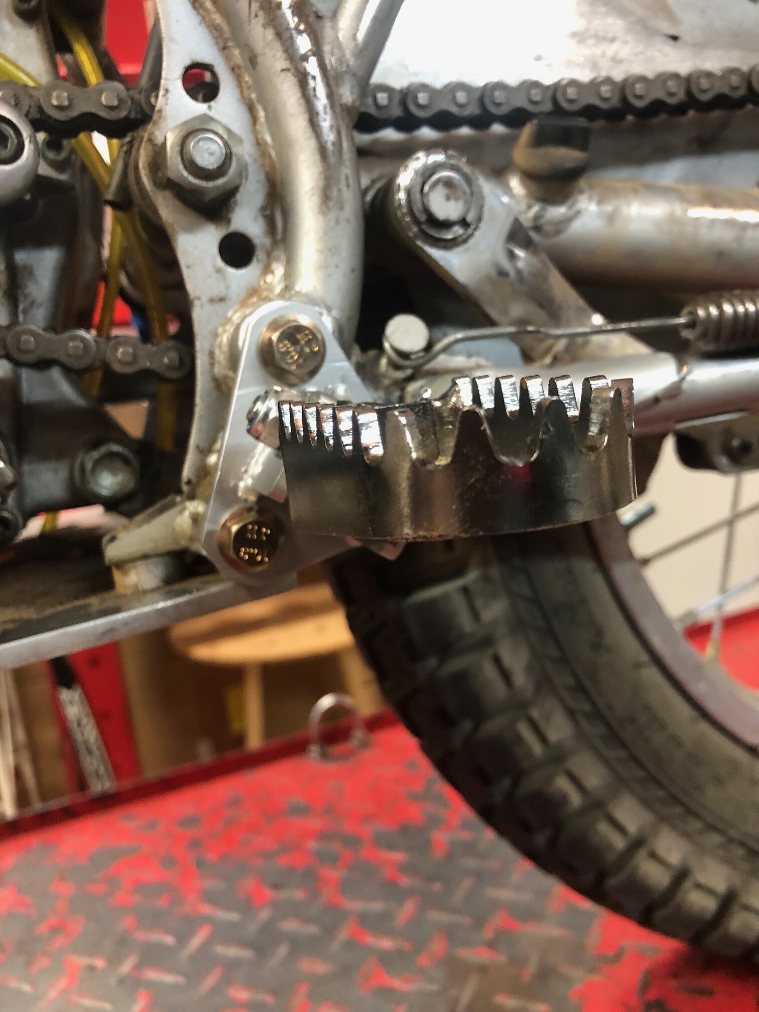

mcman56 Posted June 10, 2024 Report Share Posted June 10, 2024 (edited) I'm not sure a response to an old post will show up. I like this simple style of mount and want to do something similar. What did you do to accept the lower bolt in the frame? The tube is quite thin. Did you weld in a threaded plug? Was it tricky to avoid interference with the kickstand? Edited June 10, 2024 by mcman56 Quote Link to comment Share on other sites More sharing options...
feetupfun Posted June 11, 2024 Report Share Posted June 11, 2024 On 6/10/2024 at 8:42 PM, mcman56 said: I'm not sure a response to an old post will show up. I like this simple style of mount and want to do something similar. What did you do to accept the lower bolt in the frame? The tube is quite thin. Did you weld in a threaded plug? Was it tricky to avoid interference with the kickstand? Expand This is an old photo of one of my TY250s. The lower cross tube on some models of the TY250 has a threaded hole, as this one has, which I think has a TY250B frame. People who have a TY250 without the threaded hole fit a threaded steel plug into the tube. Some are welded, some with an interference fit. The stand is not an issue on this bike. It is mounted to the right hand side of the swingarm and does not interfere with the footpeg. It sounds like your TY250 might be an A model with the stand mounted to the main frame under the left side footpeg. This is an old photo. It now has countersunk internal hex titanium screws instead of those external hex head screws. 1 Quote Link to comment Share on other sites More sharing options...
mcman56 Posted June 11, 2024 Report Share Posted June 11, 2024 Yes, mine is a 250A. The kick stand mounts to the main frame and there is not a lot of space to move the peg. Thanks. Did you use weld on peg mounts or make your own? Quote Link to comment Share on other sites More sharing options...
feetupfun Posted June 12, 2024 Report Share Posted June 12, 2024 On 6/11/2024 at 9:28 PM, mcman56 said: Yes, mine is a 250A. The kick stand mounts to the main frame and there is not a lot of space to move the peg. Thanks. Did you use weld on peg mounts or make your own? Expand That U shaped bracket came with the footpegs Quote Link to comment Share on other sites More sharing options...
mcman56 Posted July 19, 2024 Report Share Posted July 19, 2024 (edited) Pictures and details were helpful The kickstand on the TY250A does make it a bit crowded but at least it is easy to figure out placement. There were not many options. Edited July 19, 2024 by mcman56 2 Quote Link to comment Share on other sites More sharing options...
