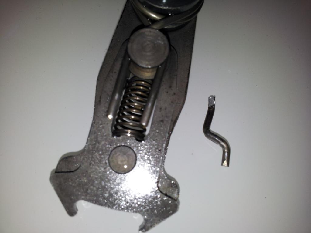

Hi there, I've recently bought a 2000 250 knowing it needed the mains changed. Having ordered and recieved all the parts need to replace the bearings(from splatshop(great service)). I've stripped the motor to the point of replacing the bearings. whilst cleaning the old gasket off I spotted a piece of sprung metal lying under the gear selector drum. Managed to get it out but on inspection I can't for the life of me work out where its from. All of the springs that I can see on the parts manual are all present and appear to be complete, also the piece does not seem to match any of them in shape. I'm gonna try and attached a couple of photo's of the metal and where I found it in the hope one of you more experienced will be able to help me outpost-18134-0-44334800-1363394372_thumb.jpgpost-18134-0-34252600-1363394669_thumb.jpg. I'm sorry if the pics are too big or don't show up .

Looks like a leg off the gearchange return spring possibly, part number RB/M110
Yes, and may have gotton cought up in the primarys at some point!, Inspect for damaged cogs in the crank gear and clutch basket.

Thanks for the replys guys,the metal piece is definatly of the same gauge as the return spring , just suprised it could of been bent into the shape it is now(being sprung steel). Gears all look good so hopefully no no more damage has been done. Haven't heard it running but was told it had an engine rumble. Anyways it has been fun stripping it down and getting to know the bike and also giving me a good chance to check it over. As I can't see any broken springs I'm going to continue with the rebuild and get it back together today hopefully.post-18134-0-31572900-1363433553_thumb.jpg

Hi mate, yeah found that one all ok. Think your right about a previous owner leaving a bit behind. the main oilway runs at the bottom of the casing and exits under the selector drum. It could even be after they realised the spring had gone they drained the oil from the box and the draining oil pulled the spring piece through the oilway and under the selector drum.
