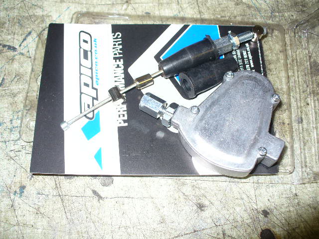

Hi I have been off my bikes for several months (valid excuse available). But before my break I was having problems with hand cramp particularly when riding my Cota 247 which has a pretty heavy clutch despite the long arm.
So a few weeks ago I ordered a part called Easy Clutch off ebay from a guy in UK for about $30AUD delivered (love our exchange rate)I only got it fitted correctly today and wow what an improvement. Gone from 3 fingers straining to 1 finger easy. Takes a bit of fiddling as intended for modern thinner cables but worth the effort Best $30 I have spent since I bought the compression release
