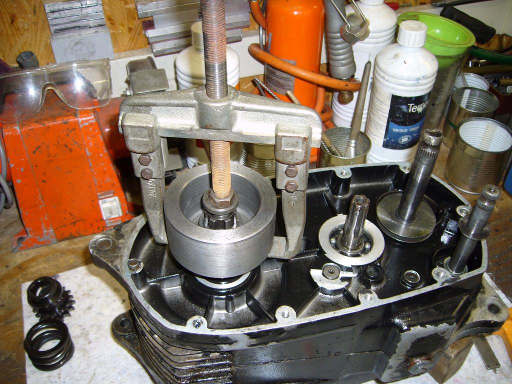

fantic303 Posted August 23, 2013 Report Share Posted August 23, 2013 (edited) Hi, Had also the problem to remove the sleeve, but did it without any special tool except a two leg puller. I rotated the flywheel 180 degrees put the two key's back which lock the flywheel, put the long special nut on the cranckshaft to keep the flywheel in place and put a two leg puller on it. For others who also find problems and don't have that special tool Edited August 23, 2013 by fantic303 Quote Link to comment Share on other sites More sharing options...
