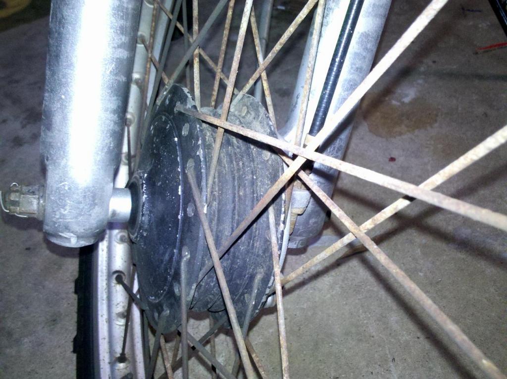

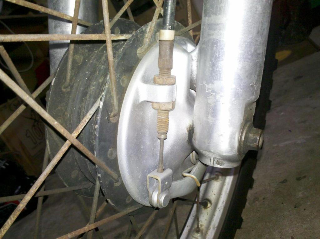

mozofoz Posted April 2, 2013 Report Share Posted April 2, 2013 Hi all, we're restoring a 76 TL 125 and just installed the front wheel to notice it is off-set about 10mm to the r/h side (when sitting on the bike). We know nothing of it's past and can't believe Honda would produce the bike like this as OEM? Does anyone have one of these little darlings or know if this is kosher?? Cheers in advance, Moz Quote Link to comment Share on other sites More sharing options...
stumpnthqldd23 Posted April 2, 2013 Report Share Posted April 2, 2013 The left side where the drum brake is runs up against the fork leg while the right side has a spacer fitted. I will add photos in a minute. Quote Link to comment Share on other sites More sharing options...
stumpnthqldd23 Posted April 2, 2013 Report Share Posted April 2, 2013 This was the best resource for me to compare parts http://www.cmsnl.com/honda-tl125s-trials-usa_model1106/partslist/?model_q=tl125s Quote Link to comment Share on other sites More sharing options...
stumpnthqldd23 Posted April 2, 2013 Report Share Posted April 2, 2013 Both these photos are from the taken from in front of the bike. Quote Link to comment Share on other sites More sharing options...
