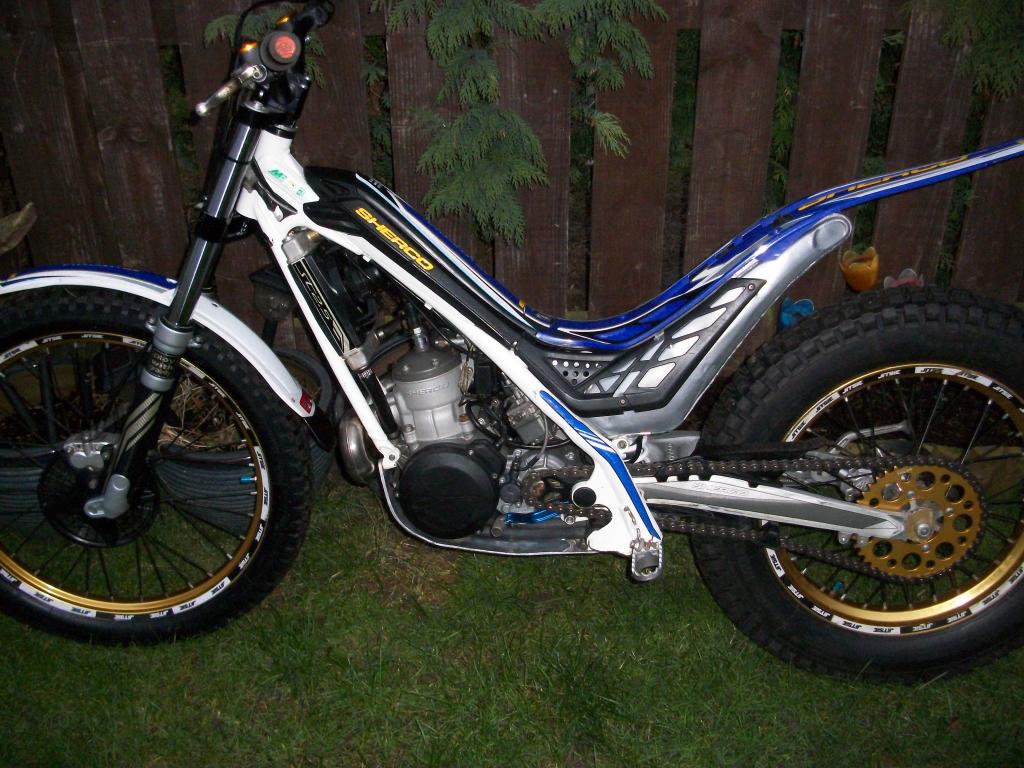

bambam_n_chunx Posted April 2, 2013 Report Share Posted April 2, 2013 Been out on the bike all weekend, going to give it a service and clean the carb out just wondered before I strip it down if any body has the original factory settings for a 2011 290 carb. The mixture screw is 4 1/2 turns out which seems a bit much to me. Quote Link to comment Share on other sites More sharing options...
