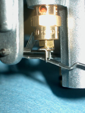

re500 Posted May 27, 2005 Report Share Posted May 27, 2005 Marlintec Does the PHBL float needle have a spring on top ? Carb doesn't seem to get warm at all, even when the motor is well toasty. Thanks for the suggestions though! Haven't popped the tank off to check the temp of the coil, i'll stick a thermocouple to it and see. Quote Link to comment Share on other sites More sharing options...
marlintec Posted May 27, 2005 Report Share Posted May 27, 2005 Sorry, RE500, I don't exactly understand what you mean with ''spring on top''. The top (tip) of this needle is covered with rubber, and the body has a tiny spring within (you cannot see it) that pushes out the T shaped part. Seems that a change on the stamping machinery of Dell'Orto has produced some defective units that were mounted on VHST carbs. You can easily found this needle on any bikeshop, but make sure that is of the same lenght and size. Also, I'd like to know your temperature tests! Ishy, I think there are people that testing the insulation sheets between head and carb, as you note. I don't know if the problem with ignition is on the HT coil or in the mag coils. The bike I referred before was changed all the electrics, and I don't have more news on which was the faulty part. Quote Link to comment Share on other sites More sharing options...
re500 Posted May 27, 2005 Report Share Posted May 27, 2005 Marlintec The needle valve has a bent thin gauge wire fixed to to the top that forms a loop. This hangs onto the float arm/lever. The float arm/lever doesnot have a notch for a T shapped needle valve to fit. Does this make any sense...if not i'll take a picture tonight. Cheers Quote Link to comment Share on other sites More sharing options...
re500 Posted May 27, 2005 Report Share Posted May 27, 2005 Here you go... Quote Link to comment Share on other sites More sharing options...
