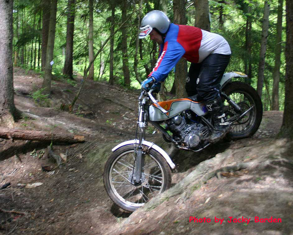

gbmoto Posted May 26, 2005 Report Share Posted May 26, 2005 Just a pic of me taken by my daughter riding my TL250 last weekend. They really are more than the trail bike people say they are. Mine is a little modified, removed lower frame rails and rear loop, XL head and flywheel, 280cc Powroll piston, betor shocks,modern tyres, and performs really well. One thing that made a huge difference was a complete new set of internals for the carb ( still available from David Silver ), suddenly an even and very slow tickover and no off idle splutter. Only real problem is the weight if you have to pick it up and then trying to start it if it has been on it's side, a good incentive to not fall off!. Quote Link to comment Share on other sites More sharing options...

huntmaster Posted May 26, 2005 Report Share Posted May 26, 2005 Mines like this... Wow! That gorgeous. It looks very competitive vs a stock TL. Aftermarket frame and bodywork too? What does it weigh? Regards, Doug Quote Link to comment Share on other sites More sharing options...
huntmaster Posted May 27, 2005 Report Share Posted May 27, 2005 The bike looks great. I was aware of some aftermarket frames available and considered something similar with my old TL myself to really transform the appearance and performance . However after finishing my Ariel HT5 I'm a little overdosed on project bikes for a while! I had one of those Honda jerseys way back! They are back in production. http://www.vintageiron.com/jerseys.cfm Quote Link to comment Share on other sites More sharing options...
gbmoto Posted May 27, 2005 Author Report Share Posted May 27, 2005 Hi All A couple of answers! Carb I use is the standard Keihin one size richer on the main. Got the jersey from Metro Racing. http://metroracing.com/cgi-local/web_store/web_store.cgi Quote Link to comment Share on other sites More sharing options...
