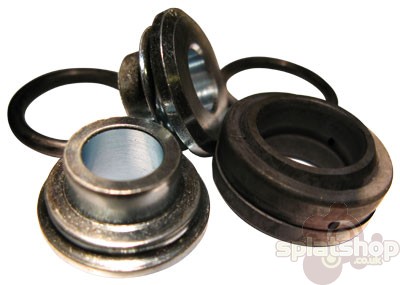

copemech Posted May 5, 2013 Report Share Posted May 5, 2013 There is a rose joint in there plus more as I recall. But firstly, the nut and bolt must be tight enough to squeeze the bushes tight to hold them. If goot-n-tight, then likely the rose joint is worn. Here is a pic of the kit from splatshop. Quote Link to comment Share on other sites More sharing options...
lewis cosgrove Posted May 5, 2013 Author Report Share Posted May 5, 2013 I think all i need to get is this, the one bearing at the top as that's the only bit with movement? http://www.splatshop.co.uk/rose-joint-bearing-ge15.html Link to exploded view : http://www.splatshop.co.uk/Parts-Finder/Sherco/2009/290/Rear-Shock-Swingarm/ Quote Link to comment Share on other sites More sharing options...
