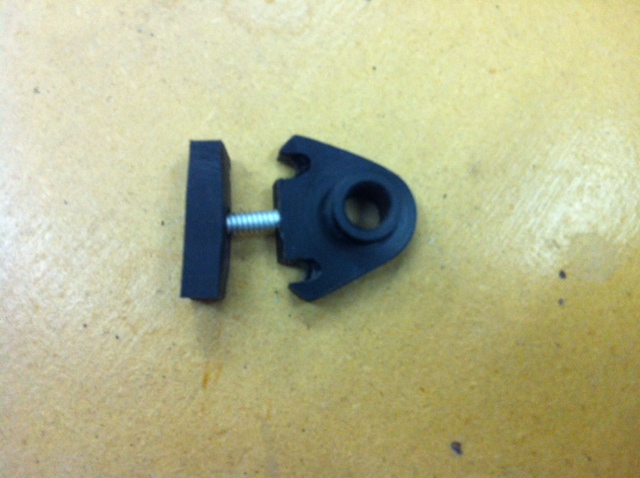

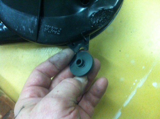

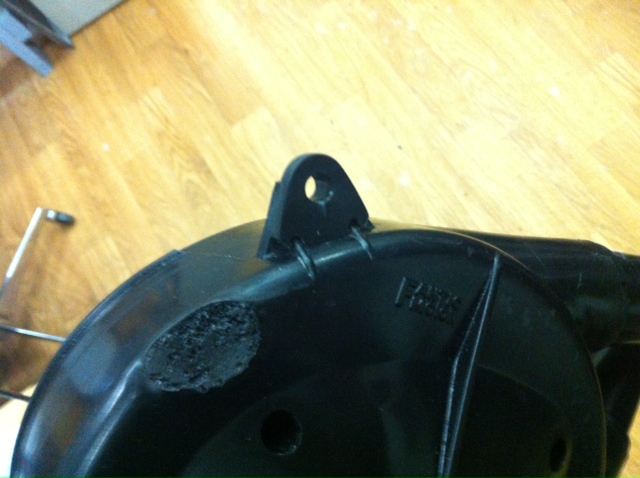

motopelli Posted January 29, 2014 Report Share Posted January 29, 2014 Fixed the broken ear on my 300 1 Quote Link to comment Share on other sites More sharing options...

motopelli Posted February 4, 2014 Report Share Posted February 4, 2014 It's bolted to the airbox. The middle picture shows a slightly curved piece that goes inside the airbox and bolts through to the new ear which is internally threaded(no glue although I'd love to find a good cement for delrin)). It holds quite well and in retrospect I think I should have cut off the original ear altogether and made a new one held with two through bolts and backing plate. May still do that. I think you said it's an addiction; indeed it is Quote Link to comment Share on other sites More sharing options...

htrdoug Posted February 14, 2014 Report Share Posted February 14, 2014 On 1/29/2014 at 1:44 AM, motopelli said: Fixed the broken ear on my 300 Keep an eye on the center post,once the airbox starts getting brittle the center post can pull loose and then the filter falls out, I had been patching mine and noticed when I got home from a ride the airbox lid laying out against the sidecover. Had to fabricate a aluminum one. Quote Link to comment Share on other sites More sharing options...
