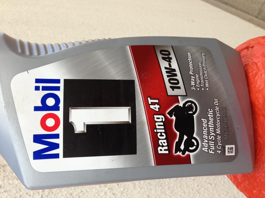

billyt Posted May 31, 2013 Author Report Share Posted May 31, 2013 (edited) I use this oil, always have in either 2T or 4T Trials bikes. It one of the best out there. With that been said it still must be compromising to be able to perform all three functions, i.e. Clutch, Gearbox, Engine. Click on picture to read the writing at the bottom of the bottle. Edited May 31, 2013 by billyt Quote Link to comment Share on other sites More sharing options...

copemech Posted May 31, 2013 Report Share Posted May 31, 2013 I use this oil, always have in either 2T or 4T Trials bikes. It one of the best out there. With that been said it still must be compromising to be able to perform all three functions, i.e. Clutch, Gearbox, Engine. Click on picture to read the writing at the bottom of the bottle. Obviousy it becomes a bit more difficult to properly lube certain 4T motors with combined motor/ gearbox vs separate items. However I seem to recall running my Hondas on 30wt with no issues back in the day, change it often. I think some of that stuff is overmarketed(spell overpriced), synthetics and all. The manufacturers provide basic recco to attend to. Not that the synthetic oils do not provide certain advantages in some applications, yet my basic findings over time remains the same. "The best oil is clean fresh oil" Quote Link to comment Share on other sites More sharing options...
