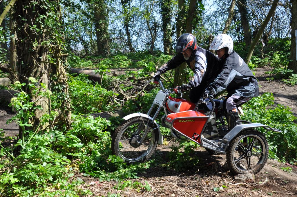

p@ul250 Posted June 8, 2013 Report Share Posted June 8, 2013 Hi bultoboy, OK Wheel lead = the centre point on the ground that the sidecar wheel touches should be 9.5"to 10.5" ahead of the centre point that the bike's rear wheel touches Track = the distance measured from the centre of the track left by the rear wheel to the centre of the track left by the sidecar wheel. Toe in = The sidecar wheel needs to point towards the front wheel of the bike very slightly, I.E. if you have a straight edge against the sidecar wheel and take a measurement from the front and rear wheel spindles of the bike. The front one will be 1.5" less than the rear measurement. In the attached photo you can see that the sidecar wheel is ahead of the bikes rear wheel (lead) follow my link on the Plans For Side Car thread to the trialshacke jpegs well worth the read. bultoboy message me your email address and I will send you loads of photos and my phone number if you wish to talk more about building/fitting a sidecar to your bike. Quote Link to comment Share on other sites More sharing options...
