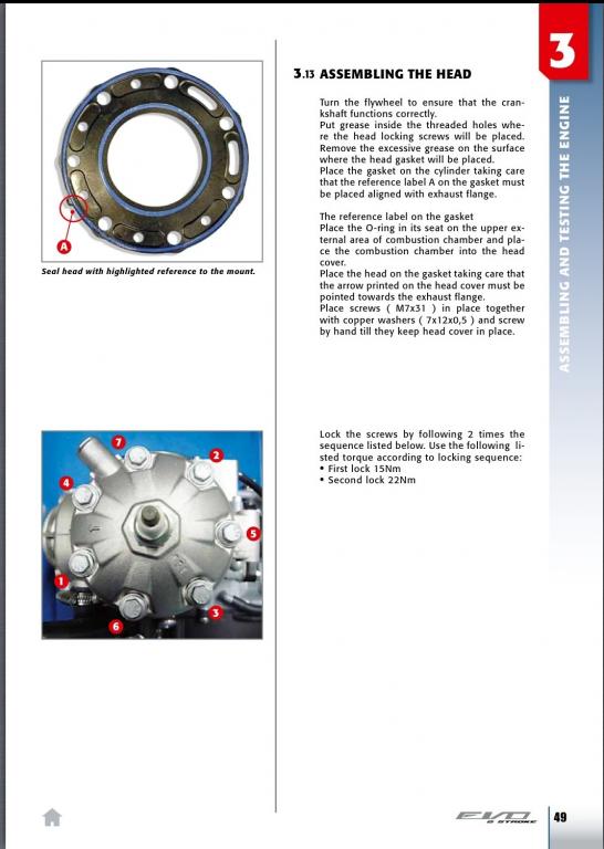

clip Posted June 17, 2013 Report Share Posted June 17, 2013 Hello,can someone tell me which way round the head gasket goes on my Beta rev 3 250 2007,as it`s not symetrical regarding the water way slots? Quote Link to comment Share on other sites More sharing options...
jfc Posted June 17, 2013 Report Share Posted June 17, 2013 Place the gasket on the cylinder taking care that the reference tab on the gasket must be placed aligned with exhaust flange Quote Link to comment Share on other sites More sharing options...
lineaway Posted June 17, 2013 Report Share Posted June 17, 2013 I have a gasket in my hand. Without having one apart, I would think the two big slots would line up with the water pipe on the head. Quote Link to comment Share on other sites More sharing options...
jfc Posted June 17, 2013 Report Share Posted June 17, 2013 (edited) Sorry photo would not upload Edited June 17, 2013 by jfc Quote Link to comment Share on other sites More sharing options...
lineaway Posted June 17, 2013 Report Share Posted June 17, 2013 I would go with JFC, it is strange though just looking at it. Quote Link to comment Share on other sites More sharing options...
jfc Posted June 17, 2013 Report Share Posted June 17, 2013 (edited) Last try!! Go steady on the stated torque setting. I don't think you will get the 22 Nm as stated without possible damage, it seams a little high! Edited June 17, 2013 by jfc Quote Link to comment Share on other sites More sharing options...
clip Posted June 17, 2013 Author Report Share Posted June 17, 2013 (edited) Hello,thanks everyone for your prompt replies.So it goes with the tab to the front,which places the two full slots to the rear,I presume the water comes up this way and then trickles back down through the holes. Thanks for the pics JFC,i have my own in built torque settings,one grunt and a squeek,it`s been off that many times latley,I just clap and it rebuilds itself. Edited June 17, 2013 by clip Quote Link to comment Share on other sites More sharing options...
