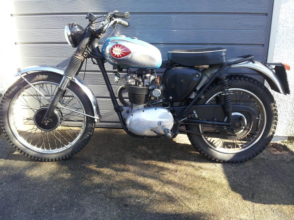

bazbro Posted July 3, 2013 Report Share Posted July 3, 2013 Hi, I've inherited my late Dad's '60 C15T and, despite not riding Trials (but a motorcyclist for over 50 years), I intend to restore it. I'm not clear yet quite how to go about it, what my priorities are or should be, and... I am NOT a mechanic! But I know my limitations and I don't intend to sod the 'bike up through ignorance. I'm going to convert it to 12v and fit Boyer Bransden electronic ignition (it was a bugger for my poor old Dad to start!) as I'm OK on electrics - I fitted a Boyer Bransden to a Sammy Miller Trials Cub I once owned. Then I need someone good to completely rebuild the engine (with the desirable mods) - someone good and not someone who just thinks they're good!! I've considered SRM (expensive) but not yet had a reply to the email I sent them. I'm unsure whether to then run it for a while in tatty condition with the good engine, or jump in with both feet, completely strip it down, powder-coat, polish, rechrome and repaint everything and then put it back again (a bit daunting for me, I confess). And none of this can start until September anyway when I have an empty garage to work in. So plenty of time to plan! I'm happy to take advice and recommendations from anywhere and anyone! This is all new for me - a classic Trials bike and a restoration too. Thanks and best wishes, Barry Quote Link to comment Share on other sites More sharing options...
maxbikes Posted July 3, 2013 Report Share Posted July 3, 2013 leave it alone,then you may use it.if restoring it you wont want to ride it.looks all good to me.do what it needs to ride in a trial.have some fun. Quote Link to comment Share on other sites More sharing options...
davetom Posted July 3, 2013 Report Share Posted July 3, 2013 I'll second that, it looks just fine as it is- they're only truly original once. Quote Link to comment Share on other sites More sharing options...
jon v8 Posted July 3, 2013 Report Share Posted July 3, 2013 Do the electronic ignition,but as Davetom and Maxbikes say - please don't restore it,just ride and enjoy it.... Quote Link to comment Share on other sites More sharing options...
gautrek Posted July 3, 2013 Report Share Posted July 3, 2013 I also would do the bare minimum to it. This is a piece of history as it stands not some over restored "new" bike. Quote Link to comment Share on other sites More sharing options...
trialsrfun Posted July 4, 2013 Report Share Posted July 4, 2013 (edited) Just fit electronic ignition, a bike that does not start or run properly is not worth the hassle, replace any worn bits in the carb, check & replace cables as reqd, strip & reassemble the brakes to see if the linings are still good & secured to the shoes, replace tyres if they are old and had it then wipe over with an oily rag, job done. Edited July 4, 2013 by trialsrfun 1 Quote Link to comment Share on other sites More sharing options...
old trials fanatic Posted July 4, 2013 Report Share Posted July 4, 2013 I agree with everybody else. the world is full of over restored bikes and to be honest competition bikes should be used not bloody garage queens for all the anoraks at shows to endlessly debate about. the bike is a bit of a difficult one in as much as it would be a shame to change it other than renew worn parts etc as it's great as is. There would be no point in trying to ride it competitively either as it will get trashed. So it's future is probably green laneing while we still can or the occasional long distance trial. Whatever it's your bike so up to you but i'd just keep it as is and replace tyres, you might struggle to find a front though, and possibly electronic ignition. Boyer is ok if you're not serious about competing on it. 2 Quote Link to comment Share on other sites More sharing options...
sparks2 Posted July 4, 2013 Report Share Posted July 4, 2013 Congratulations -- You have quite a rarity - a BSA C15T as it came from Small Heath. I would agree with all of the above , preserve the bike for what it is. Regards Sparks2 Quote Link to comment Share on other sites More sharing options...

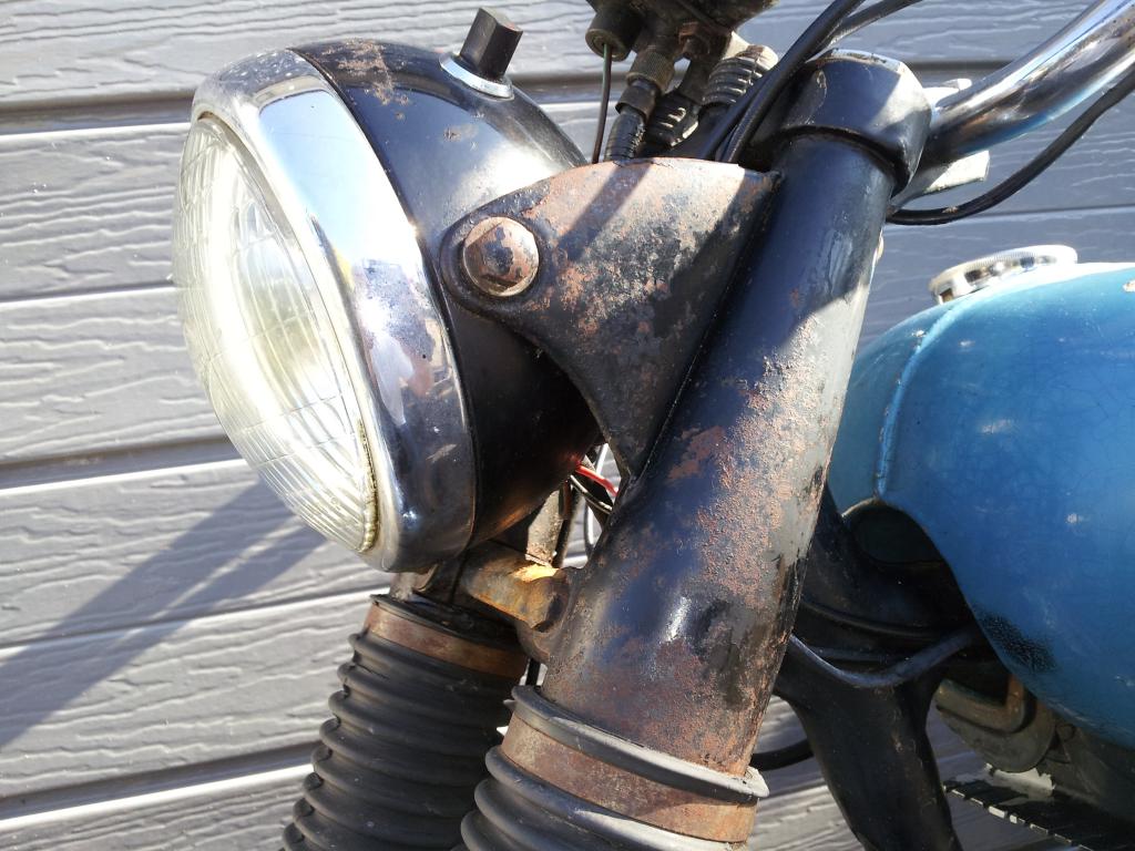

bazbro Posted July 9, 2013 Author Report Share Posted July 9, 2013 Thank you all SO much for your responses - more interest than I hoped for and a lot for me to consider. I'm in a real quandary now... I'm approaching 70 and I've never ridden Trials (but an enthusiastic spectator!) so I really can't see me starting now. I've actually tried off-road and it ain't for me! I tested one of the Met Police ISDT 500 Triumphs ('Mini' Minskip's 'bike, for any that knew him) at Hungry Hill and I terrified myself, descending a steep sandy gully far too fast and unable to stop. Unable to do anything actually, apart from hang on for dear life and pray! Even Green Lane-ing on a DRZ400 was a miserable experience. So I don't think this C15T will ever go off-road in my incapable hands! It's rusting and the engine's not run for over 10 years, maybe even 15 (my Dad was 97 when he passed away). The photos belie the true poor state that it's in. But nevertheless, you've given me another angle to consider - someone else said "Just get it past an MoT and ride it" and you all seem to concur with that. Hmmm... Quote Link to comment Share on other sites More sharing options...

bazbro Posted July 9, 2013 Author Report Share Posted July 9, 2013 Thanks for that, Sparks. I'm gradually getting my head round what I would like to achieve with this, and I've taken on board all your comments, folks. Clearly, the engine has got to run, run reliably, and start easily!!! So that's Number One task. Then brakes, suspension, cables and wiring - all working properly. New tyres, then MoT it and ride it. Yes? I can let the rust fester for a bit longer while I think about things, but I know the horrible appearance will eventually get to me! Then I'll just have to restore a few bits, the worst bits. Like the fork headlamp brackets... Quote Link to comment Share on other sites More sharing options...
sparks2 Posted July 10, 2013 Report Share Posted July 10, 2013 That's nothing more than light surface rust. Nothing to worry about. An occasional wipe with WD40 will suffice. Quote Link to comment Share on other sites More sharing options...
